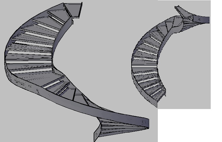

SLW210 I'm not requiring a view it's the actual stringer that supports the treads that I require to create a fabrication drawing of, with lengths hieghts etc see attached drawing, basically I require the plate to be flat with all sizes prior to rolling it to the required radius.
stevsmith, Your right mate major bummer like !!! been doing these type of stairs for years and you would think there was some way of creating the fabrication drawing by now !!!!
I have attached a quick view of the stair to show what I'm talking about SLW210

I had to do a twin stringer helix stair case for stirling castle that was a nightmare. The helix came around 180 degrees then went the opposite way at 90 degrees with no landing.
I may have a pic somewhere. give me 5.

It was an absolute nightmare. It was stainless steel stringers as well with a glass infill balustrade. :shock: :shock: :shock: :shock:
The transition points were difficult, especially on the inner stringer that comes on the second curve.

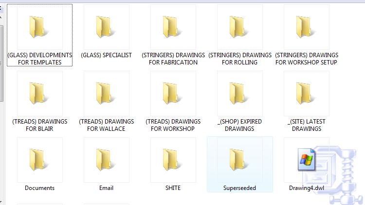

I had to do the main submit drawings for approval. (about 5 or 6 dwgs) Site layout drawings (about 15) workshop layout drawings (10~12) fabrication drawings (40+) development drawings for the stringers to get the contractors to roll them (10~12) Laser profile drawings (5~6) and glass paenle developments (15 ish)
All in all, about 100 drawings.
