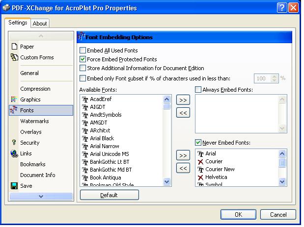

I hadn't looked at the Custom Properties before. Does it have to do with Embedding Fonts? Arial is under "never embed fonts".
