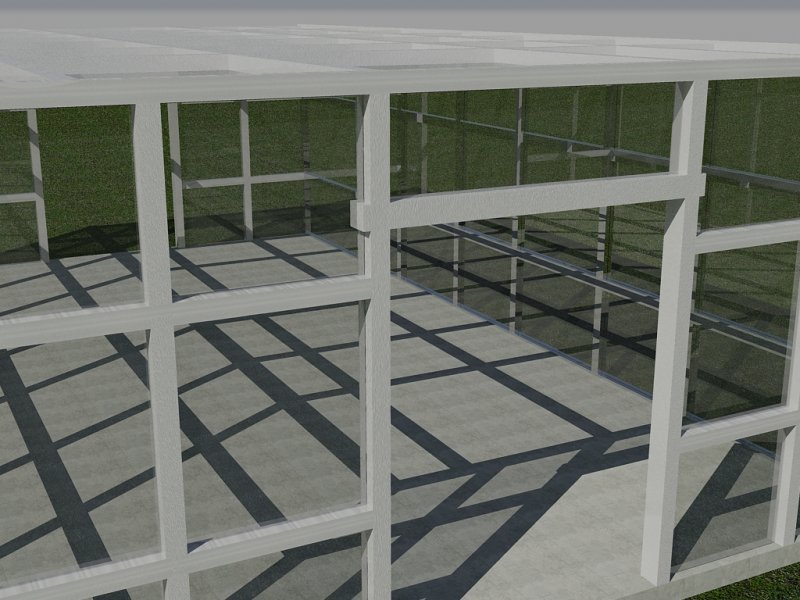

Raudel Solis Posted March 29, 2011 Share Posted March 29, 2011 windows 7 includes a snipping tool. "fraps" is good.http://www.fraps.com/ give me abour 2 hours from 7:58 central and il cough up a green house in autocad, il explain the glass part any blueprints i can go on? Quote Link to comment Share on other sites More sharing options...

Raudel Solis Posted April 2, 2011 Share Posted April 2, 2011 due to a series of unfortunate events i could not reply anyways i did manage to finish this in only 2-4 hours of total use typical glass frame is set up and waterproofed with sillicon or a similar type of sealant. hmm... give me your opinion is the "greenhouse" structurally stable? my answer is no, but give me your opinion dimensions 35*15 slab 6" thickness "standard for commercial projects top of slab @ 0' above sea level "0 elevation" Aluminum material .5" thick plastic Ehh i could not think of a way to incorporate a door yet Max height estimated at 10' to 10' 6" the 4 corners are almost solid they just have a -.5" inset for the glass... the rest are all 4x4, technically since the glass splits them down the middle its 4 lenght by 1.75" frame Quote Link to comment Share on other sites More sharing options...
