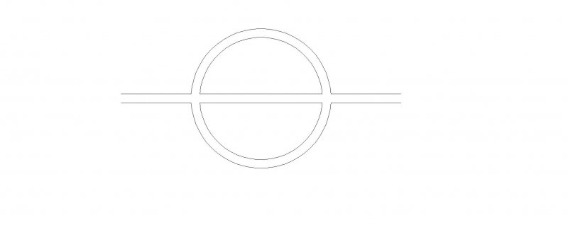

Post an image. It almost sounds as though either the circles or the straight wall need to be trimmed.
Is this the situation you are describing?

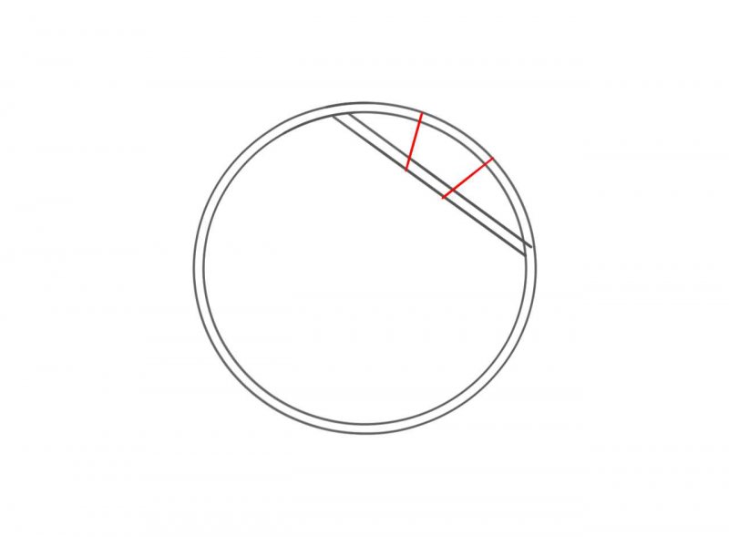

Hi thanks for the responses. Im not sure how to attach direct from autocad so I hope this image works. What I want to draw is the 2 red lines.
Meant to mention that they are not inline with the center of the circles and I would want to remove the sections between them. Thanks

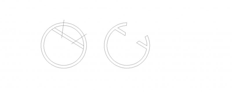

Use the TRIM command to cut out what you don't want.
Use the PEDIT command with the JOIN option to combine the lines and arc segments into continuous polylines.
Thank you - I shall go and give it a go.
One end product of your lines and circles.
