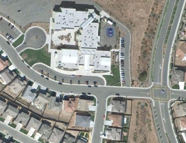

zodiacs Posted March 18, 2011 Posted March 18, 2011 I've tried MSLTSCALE, LTSCALE and PSLTSCALE set to various numbers, but none of them work. any other suggestions? Quote

zodiacs Posted March 18, 2011 Author Posted March 18, 2011 Here is the drawing. Also thanks everyone who is trying to help an autocad novice like me! heh Pilar-Rio-School.dwgFetching info... Quote
rkent Posted March 18, 2011 Posted March 18, 2011 When I open your drawing and check a dimension I see that it is not close to actual size. A 12' width measure 1/32" (or less). Draw to true size so 12' is either 12 units or 144 units (if using inches and not feet). Once I scaled the objects up the linetype worked fine. The line had a thickness set to it, which gives a Z thickness. If you want a wider line use the pline command and specify a width. Also the line was set to a linetype rather than a layer set with a linetype. Generally it is better to have a layer with the linetype you want and draw on that layer for dashed lines, etc. Don't use the "ISO" line types, load the others, dashed, hidden, etc. with out the ISO in the name. Finally, FOR 2008, 2009, 2010, 2011 MSLTSCALE = 1 LTSCALE = 0.5 (this can be adjusted up or down based on personal preference, etc.) PSLTSCALE = 1 Once set you never have to adjust again while going from PS to MS. Quote
zodiacs Posted March 18, 2011 Author Posted March 18, 2011 Yeah, the 12 width measurement wasn't to scale. Just to let them know roughly where to paint the new lines. Thanks for all the help though rkent, i'll get working on it. Quote
nestly Posted March 18, 2011 Posted March 18, 2011 Your drawing isn't 1:1 ..... it's 0.03710196 = 12'-0" To draw at 1:1 you'll have to scale your .bmp and all your existing objects up with the reference option so your lanes are actually 12 feet wide instead of making your drawing fit the .bmp image and then over-riding the dimensions. You'll also have to change your dimstyles, but that's really the direction you need to go to be proficient in AutoCAD. If you can attach the bmp, I'll try to get things lined up so you can compare how you're doing it now to how it's done at full scale. Quote
rkent Posted March 18, 2011 Posted March 18, 2011 Yeah, I was going to also say when tracing over an image to scale it up to true size. I am guessing this is the area according to google maps. Quote

zodiacs Posted March 19, 2011 Author Posted March 19, 2011 Thanks for all the help guys, I got it figured out. When you guys said 1:1, I thought it was the "annotation" 1:1 scale. not 1 feet = 1 feet. Quote
