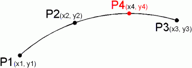

MSasu Posted March 18, 2011 Share Posted March 18, 2011 I have to admit, the analytic geometry wasn’t my preferred field of study and this pay back sometime. I’m trying to find the formula to locate a point on an arc given by 3 points. In the sketch below I know the X and Y coordinates of points P1, P2 and P3, respectively the X coordinate of point P4 – I’m looking for the formula to find the Y coordinate of point P4 using the arc equation (all points are laying on the arc). I will appreciate if someone can help me on this mater. Thank you. Regards, Mircea Quote Link to comment Share on other sites More sharing options...
David Bethel Posted March 18, 2011 Share Posted March 18, 2011 I think you are going to need to enlighten us a bit more Given the 3 points, we can find the center, radius, start angle, end angle, included angle, chord data and a lot of other stuff. You will need to set some parameters for P4. Is is half way form P2 to P3 ? What is the basis for P4? -David Quote Link to comment Share on other sites More sharing options...

MSasu Posted March 18, 2011 Author Share Posted March 18, 2011 Based on the above sketch: input X1, Y1 X2, Y2 X3, Y3 X4 (where X1 < X4 < X3) output Y4 Hope that this is a better explanation. Thank you. Regards, Mircea Quote Link to comment Share on other sites More sharing options...
David Bethel Posted March 18, 2011 Share Posted March 18, 2011 What happens when the arc goes thru 180 degrees? There can be 2 solutions to the problem. -David Quote Link to comment Share on other sites More sharing options...
hmspe Posted March 18, 2011 Share Posted March 18, 2011 For a mathematical approach I'd try treating the arc as a circle. With the center point, radius, and an x value you can use the equation for a circle to solve for two y values. You could use vlax-curve-getClosestPointTo to determine which of the points is on the arc. From the general equation for a circle (x - h)^2 + (y - k)^2 = r^2, where h is the x value for the center, k is the y value of the center, r is the radius, and x is the x value of the point you are looking for, y = k + (r^2 - (x - h)^2)^2 y = k - (r^2 - (x - h)^2)^2 For a mechanical approach create a line from (x4 , -10) to (x4 , 10), then use use 'IntersectWith to find the actual point, then erase the temporary line. You would need to set the variable in the IntersectWith function to extend only the line. An example for the IntersectWith function is VXGetInters from http://www.menziengineering.ch/Downloads/Download.htm#17 Quote Link to comment Share on other sites More sharing options...
MSasu Posted March 18, 2011 Author Share Posted March 18, 2011 What happens when the arc goes thru 180 degrees? There can be 2 solutions to the problem. -David Yes, you are right, if the arc is bigger than 180 degrees may get two intersections - however this can't happen with my data. The Y coordinate of center will always be located below Y1, Y2 and Y3. Regards, Mircea Quote Link to comment Share on other sites More sharing options...

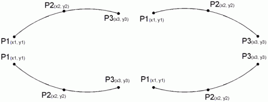

Sittingbull Posted March 18, 2011 Share Posted March 18, 2011 Is there a relationship between the coordinates? Could you post some of them? Are they results of other calculations? regards, SB Quote Link to comment Share on other sites More sharing options...
Lee Mac Posted March 18, 2011 Share Posted March 18, 2011 This will return the two y-values for the two points on the circle defined by p1, p2 & p3 for the specified value of x4: (defun test ( p1 p2 p3 x4 / _mid m1 m2 c1 r1 y4 ) (defun _mid ( a b ) (mapcar '/ (mapcar '+ a b) '(2. 2.))) (setq m1 (_mid p1 p2) m2 (_mid p2 p3) ) (setq c1 (inters m1 (polar m1 (+ (angle p1 p2) (/ pi 2.)) 1.) m2 (polar m2 (+ (angle p2 p3) (/ pi 2.)) 1.) nil ) ) (setq r1 (distance c1 p1) x4 (- x4 (car c1)) y4 (sqrt (- (* r1 r1) (* x4 x4))) ) (mapcar '+ (list y4 (- y4)) (list (cadr c1) (cadr c1))) ) Quote Link to comment Share on other sites More sharing options...

MSasu Posted March 18, 2011 Author Share Posted March 18, 2011 Is there a relationship between the coordinates? Basically, there are 4 possible cases: Regards, Mircea Quote Link to comment Share on other sites More sharing options...
SEANT Posted March 18, 2011 Share Posted March 18, 2011 Here is a mathematical method, point-slope, matrix, etc. The spreadsheet gives both points. ArcPoints.zip Quote Link to comment Share on other sites More sharing options...
MSasu Posted March 21, 2011 Author Share Posted March 21, 2011 @SEANT: just played a little with your calculator and is simply amaizing! THis is exact what I was looking for. Thank you very much for your help! Regards, Mircea Quote Link to comment Share on other sites More sharing options...
SEANT Posted March 21, 2011 Share Posted March 21, 2011 I’m happy that it helped. The spreadsheet does not have all the necessary error checking (it will fail if any pair of the three points are stacked perfectly vertical) but that should be easy enough to do when transferred to code. Quote Link to comment Share on other sites More sharing options...
