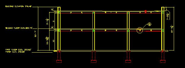

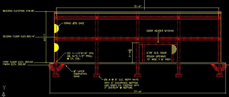

Car5858 Posted March 22, 2011 Share Posted March 22, 2011 (edited) Refer to post 17, this is what you should see. The horz. section line with the indicators tells you what direction you are looking. So If you are looking at the building you would see an elevation view of the bottom line on the image in post 17. This is called the South Elevation. By using copy and paste, you can quickly lay out this elevation in the new drawing. Edited March 22, 2011 by Car5858 Quote Link to comment Share on other sites More sharing options...
Autocadstudent Posted March 22, 2011 Author Share Posted March 22, 2011 where do i see post 17? man i can't believe i don't see post 17. Quote Link to comment Share on other sites More sharing options...
Car5858 Posted March 22, 2011 Share Posted March 22, 2011 Look in the top right corner of each post, the number of the post appears there. For instance this is post #31 Quote Link to comment Share on other sites More sharing options...
Autocadstudent Posted March 22, 2011 Author Share Posted March 22, 2011 I see it now. let me prosess what said before. Quote Link to comment Share on other sites More sharing options...

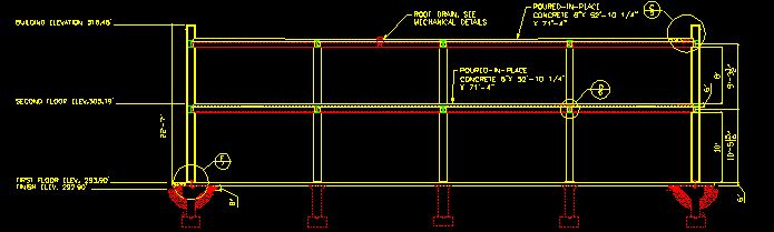

Autocadstudent Posted March 22, 2011 Author Share Posted March 22, 2011 ok, so from the horizontal cutting line to to the bottom of the drawing (to the d bubble) that will be the south elevation. from that same cutting to bubble A will be the north elevation with out counting the vertical cutting linr. is that right? Quote Link to comment Share on other sites More sharing options...
Autocadstudent Posted March 22, 2011 Author Share Posted March 22, 2011 since the horizontal cutting line is in the middle. i will be copying a 72' long x 27' high rectangle. man am i even close to what you are traying to tell me car5858? Quote Link to comment Share on other sites More sharing options...
Car5858 Posted March 22, 2011 Share Posted March 22, 2011 This is what it should look like. Hopefuly this will eleminate the situation you seem to be in currently. Quote Link to comment Share on other sites More sharing options...

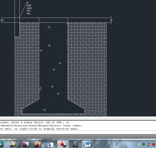

Raudel Solis Posted March 23, 2011 Share Posted March 23, 2011 (edited) though what is up with the building structure i would expect to see a concrete cylinder under the foundation to which the I beams or 6*6 are supported by example 5'O/s CLAB 5'R Bell? is what the site surveyor would be drawing on the flags five foot off set center line A-B five foot Radius Bell the bell is to have a larger surface area for support at the bottom to prevent movement of the piers il post Example drawing file--as soon as i fix my Acad, ... Acad Mechanical is messing around with it Edited March 23, 2011 by Raudel Solis Quote Link to comment Share on other sites More sharing options...
Car5858 Posted March 23, 2011 Share Posted March 23, 2011 The screen shots that I have posted were dated 2009, requirements may have changed. Penn Foster had sent me a distorted hand out much like the screen shot as an example. If the student requests assistance from Penn Foster they will send something like the drawing that is in question. There is a discription of the footing and piers that the columns are on. We have to wait for the student to get to that section. As far as the learning goes we are not doing the drawing for the students, they still have to do them on there own. When trying to explain certian aspects of the drawing instruction, a picture helps the student to understand what is required. I also advise the students to visit various construction sites, and look for the details of the building the is under construction. They get a better idea of what they are drawing with this experience. Raudel, The peirs are wiewal in the 3 screen shots, just not detailed. Quote Link to comment Share on other sites More sharing options...
ReMark Posted March 23, 2011 Share Posted March 23, 2011 are yall posting the actual completed drawings he is working on?this eliminates the ability to learn Given the level of actual discernable detail the images provide I doubt that the student in this case is going to benefit as much as you think. Images are posted instead of drawing files to prevent the student from downloading them and submitting the work as his own. We're pretty careful that way. Quote Link to comment Share on other sites More sharing options...
