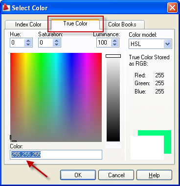

Kevin_S Posted March 4, 2011 Author Share Posted March 4, 2011 Thanks, all. I appreciate the help. Unfortunately, I'm pretty much brand new to autoCAD and after having tried to play around with the suggestions made, I think I'm simply not understanding what you're recommending. For example -- and this may be an issue of it being '05 -- when I hatch, it only wants a single value for the color. The result of using 255 is a white circle; I don't see the number inside. And the real trouble is that there are a few thousand such objects in the master drawing. Seems like refedit (a new command for me) will let me modify them all at once. But I'm still hazy on the changes I need to make. Apologies if this is a magnificently elementary question, and thanks again for taking the time to help. Quote Link to comment Share on other sites More sharing options...
BlackBox Posted March 4, 2011 Share Posted March 4, 2011 ... when I hatch, it only wants a single value for the color. The result of using 255 is a white circle; I don't see the number inside. ... No worries, we all start somewhere. When selecting a color for your hatch, you get the select color dialog... go to the 'True Color' tab, then enter 255,255,255, like this (see attached): Quote Link to comment Share on other sites More sharing options...
