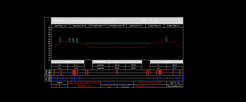

shahidchaudhry Posted January 7, 2013 Posted January 7, 2013 i have excel vba file for draw x-section of canal in auto cad but i don,t know how to attach file here in this forum. if any body intrested for this please contact me. Regards:- Shahid Chaudhry shahidchaudhry55@yahoo.com shahidjutt55@hotmail.com 1 Quote
