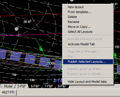

Is there a way to load the P.S. layout sheets only, and not model space? At present, I just load the needed files and then select/delete the M.S. layouts.
You could select the layouts you want to plot, right-click and select publish selected layouts.publish.png
