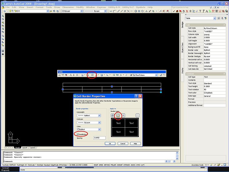

chelsea1307 Posted September 26, 2008 Author Posted September 26, 2008 I think this might be my last question. On the double line border is there a way to make the inside line a different color from the outside line? Quote
lpseifert Posted September 26, 2008 Posted September 26, 2008 Here's the way I did it... Select the cells with a crossing window (not the whole table) A 'Table' menu should pop up Click on the Border button Check Double line Border type > Outline OK Quote
