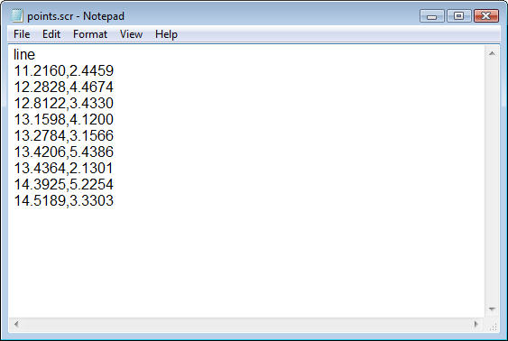

Create a script file from it just add LINE as the top line and only the X,Y coordinates with NotePAD and save with a scr extentsion. Then run that script. Provide the points are in the order you want to draw the lines.

Better still just type Line then cut and paste your x,y co-ordinates into the command line ! yes it works !
If you have lots of seperate lines then use the script method you just need an "enter" to stop and start the groups you dont need a "line" as the enter will repeat the line command.
line
1,1
2,2
3,3
5,5
6,5
5,4
etc
