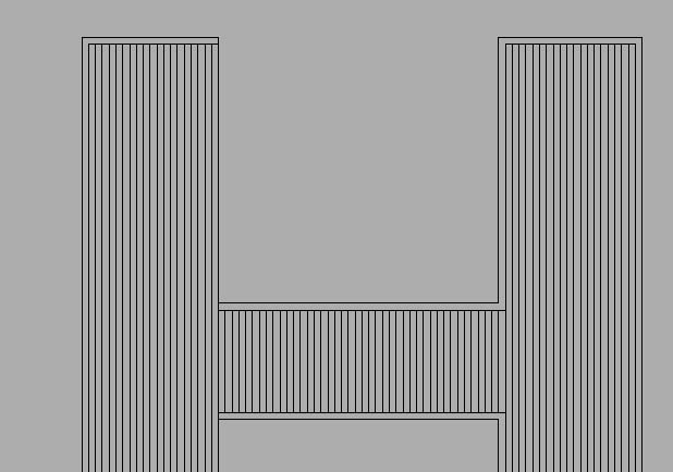

eldon Posted February 26, 2011 Posted February 26, 2011 samifox said: why autodesk bother to develop shx files? Because they needed a font before there were True Type Fonts. The shx fonts were designed with a single line, so that they could be plotted with a pen plotter. Pen plotters did not like TTF, and spent ages plotting one character because of filling in the solid shape Quote
ReMark Posted February 26, 2011 Posted February 26, 2011 SHX fonts can have more than one line. Romans, romanc and romant have one, two and three lines, respectively, that form the letters. Quote
eldon Posted February 26, 2011 Posted February 26, 2011 ReMark said: SHX fonts can have more than one line. Romans, romanc and romant have one, two and three lines, respectively, that form the letters. Very true - not much gets past ReMark. But the fonts were still designed for individual penstrokes, whether there were one, two, three or even more lines. Some 'solid' fonts were designed with adjacent penstrokes. Quote
