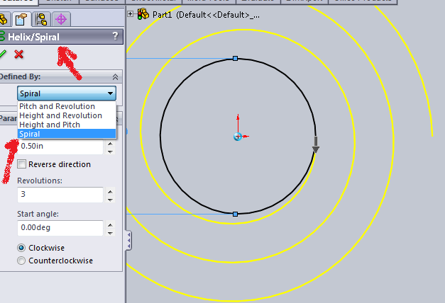

I'm desigening Scroll Compressor and don know how to draw Spiral (as showen below) in solidworks......I made it with splinge but it's not perfect ....please suggest how to draw it.

I'm surprised that you didn't find it - it is almost identical to Inventor. (see attached image)

SW now allows you to create an equation driven spline using a parametric equation. Spiral is much easier though :)
