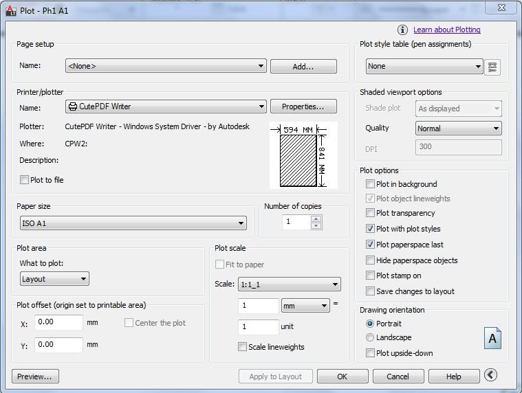

ReMark Posted March 1, 2011 Posted March 1, 2011 "Im finding this error when Im double checking the scale of the plotted drawing." Tell us what all your plot parameters are or provide a screen shot of the plot dialog box. Quote

MisterJingles Posted March 1, 2011 Author Posted March 1, 2011 No I learnt my lesson with Fit to paper long ago. But Ive made some sort of breakthrough. ReMarks question prompted me to do something. What I do when I plot is I first plot the drawing to PDF as we are forever emailing PDFs around, I usually then plot the PDF. Which is what I was doing when I picked up the above problem. So Ive just printed directly from Autocad and the scale is correct. Does anyone know why or should I head off to the pdftutor people? Heres the screenshot as requested nonetheless, perhaps it gives someone an idea of why my PDF is coming out at a slightly reduced scale? Quote

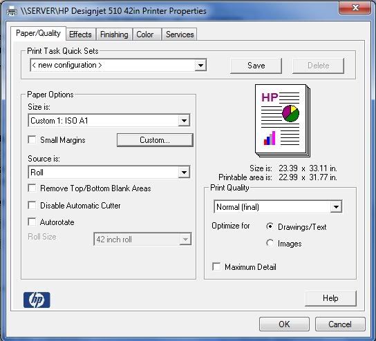

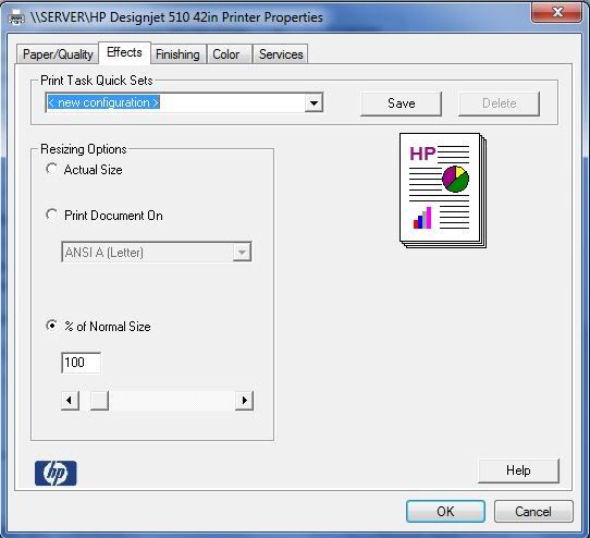

MisterJingles Posted March 2, 2011 Author Posted March 2, 2011 Hi guys. Im plotting via HP DesignJet 510. Im getting nervous here as I regularly email PDFs off to contractors. It really speeds things up. Alot of the time we will supply 1 hard copy and 1 set of PDFs which the contractor can plot themselves if necessary. So the risk that they could have 2 sets of the same drawing at different scales is very real. I have selected A1 sheet size and rotating the drawing on A0 paper. I haven't tested this problem on A0. Tiger here are screenshots from what I think are the 3 main windows. I thought it could be because I send the job as a Bitmap but have tried it either way and still no luck. Quote
Tiger Posted March 2, 2011 Posted March 2, 2011 On the first image, in the middle you have Page Scaling which is now set to Fit to Printable Area - that is where you need to look. Also, below the litte preview is a percent-value that tells you if the plotted product is scaled or not. When scale is an issue I make sure that the Page Scaling is set to none, then there is no percent-value displayed and the drawing is plotted correctly. This happens, I think, because of margins. Your paper-plotter has different margins (i.e. needs some) than a PDF-plotter that can basically have no margins at all if you want. Quote
