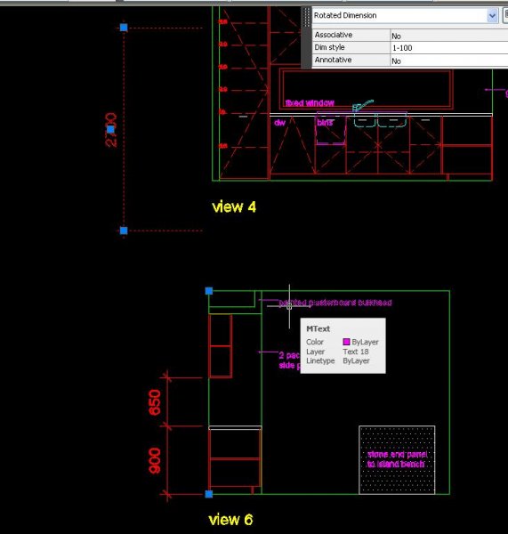

Hey Guys, I've searched and not been able to find a solution to my problem. I'm a bit of a novice in CAD and trying to do some architectural drawings.
When I use dimlin to dimension an object, it offsets the dimension line and text as can be seen in my attached picture. I can mess around a bit and line it up properly using the reassociate dimension tool. This problem only started happening yesterday.
As can be seen in my image, I've tried to dimension the overall height in View 6 however the actual dimension has appeared too high. The other heights in view 6 were pulled back down then reassociated.
Any help would be greatly appreciated. Especially if you could describe a solution in terms for a novice.
Cheers
Dane

Are you dimensioning in model space or in a layout?
Osnap is on and in Model space. It snaps to the corners I want in the below elevation, but puts the dimension in the wrong spot. Are there any other details I can provide to help solve this?
Could you post the file? Is it just in this drawing?
Yes it does appear to be just this file. File attached - I had to hack away at it to get it under 250kb. Hope this helps.

Good lord!!!. The dimension problem is the least of your issues. I unfroze a bunch of layers in order to find out why zoom extents showed so much blank model space and was agast at what I found. I am not sure what I see, but it ain't real good.
I tried a couple of moves of lines. NOTHING is snapping to an exact point, in fact it seems as though it goes out of its way to avoid a snap by several units.
Wait, it could be me. It's early yet. Was any part of this done in 3D? If so, I will go back into my cave where it's warm and not say any more.
The objects are not a Z elevation of 0, the one line I listed showed it at 16000'.
First, as was pointed out, thaw and turn on all layers and erase what is not needed. Then use flatten on the rest to bring everything to a Z elevation of 0.
The reason the dims are not aligning is because someone changed the plan view, rotated along the X axis so the two views would show. This is wrong on many levels and causes the lines in the Y axis to be displayed foreshortened and of course dims don't line up unless you move the UCS to that elevation.
If I use the UCS, object command and then dimension the dims stay where I want them but I wouldn't use that solution, see my first paragraph instead.

Exactly what I thought, I was thinking rotated UCS or non 0 Z values. Glad you have it sorted.

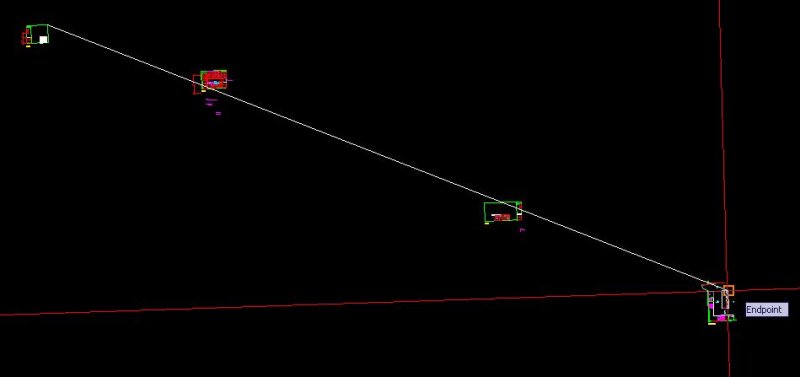

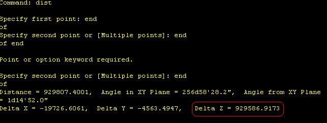

Here's what rkent is talking about. In this screenshot, I've orbited around to show you the spread in the z axis, then invoked the distance command from the corner of the green triangle in the back to the corner of the white triangle in the front:
This is how out of whack you are in the Z axis. Till you fix this, your dims are never going to line up properly, nor will you get accurate distances.
