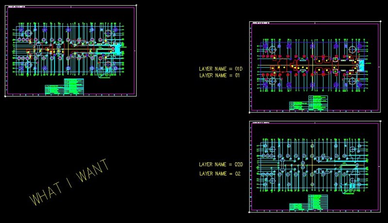

I think his problem is in his first ssget selection, he's selecting objects on multiple layers. The first time for each layer is fine, but if it's repeated, all hell breaks loose.
Is this what you are after?

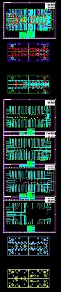

problem is, when user select the object target 2nd time, all layer copy duplicate
to new location,
pls test it... what i mean :)

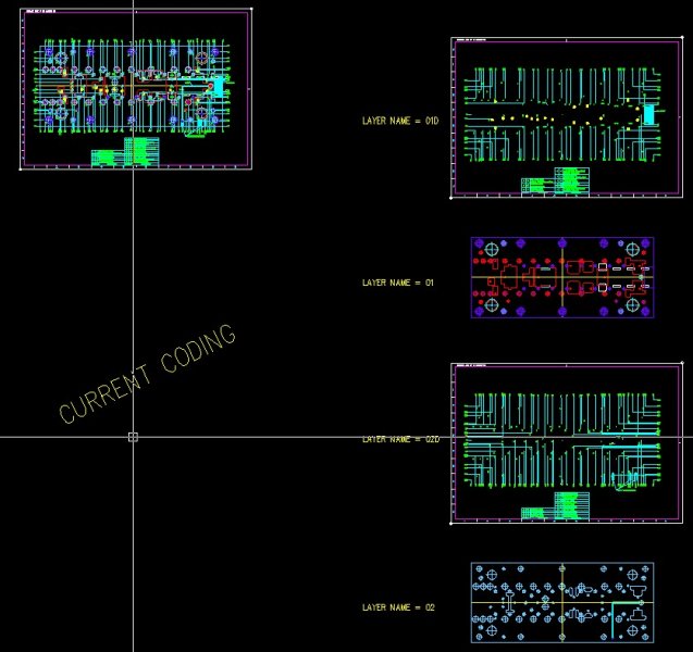

other issue, my layer have 2 type, 01,02,03... and so on.... is object and 01D,02D,03D... and so on is for DIMENSION layer, all dimension layer have "D" behind number, so i want the layer 01 and 01D is are same location (overlap), with the current coding is separated all layer individual

the problem now is, the layer is not sorting,
sorting like this Top is layer=01,01D 2nd layer=02,02D and so on...

this code is for detailing by layer name the layer must all open/show, user select the all layer and give the place point, my problem with this code is, the layer is not sort by number (my layer is 01 02 03 04 and so on) and sometime double copy with same layer name. any solution pls tq
