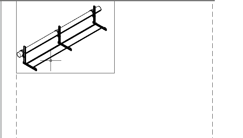

Hi all, :)
I Tried to put my 3d isometric for this Item a lot but i cant :(
so, how can i put any 3d drawing in the same model tab ??:roll: ,,,
** the attachment image will be clearly for more information :geek:

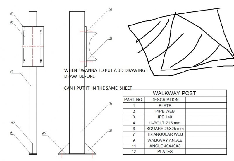

TOP ,FRONT and side views ???
I cant put it also in the same paper ???????????!!!!!11111
Here's a snapshot for the drawing and u'll find the original file -dwg- in the attachment

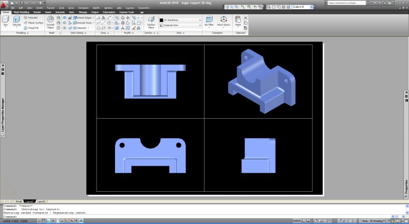

This is an example of the use of MView in a paper space layout. I used the options "4" and "Fit" to create the four viewports and fit them to an ANSI B (11.00x17.00) sheet.
Each viewport is the same scale. Since the object, an auger support, was fairly small to begin with I could use a scale of 1:1 for my viewports. I've elected to show a top, front, right side and SE isometric view. I could have gone with other choices if so desired.
