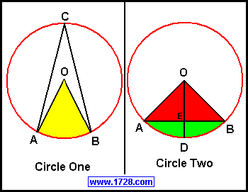

David Bethel Posted February 15, 2011 Posted February 15, 2011 In plain Autolisp, I'm needing to calculate some arc info: I have: 1) A known ( fixed ) chord length AB ( 84" ) 2) A specified segment height ED ( from 1" to 42" ) I looking for the ARC radius OA / OB and the central angle AOB I have a lot of ARC formulas but not these 2. Thanks -David Quote

David Bethel Posted February 15, 2011 Author Posted February 15, 2011 Thanks ! I was leaning to the perpendiculars of AD and BD to find the center. Kind of a klulge to say the least. -David Quote

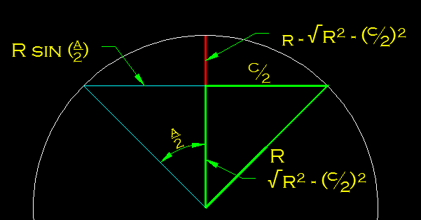

Lee Mac Posted February 15, 2011 Posted February 15, 2011 Mine uses rearrangements of the identities shown on this (badly drawn) diagram: s = segment height r = radius c = chord length a = angle ---------------------------------------------- Radius ---------------------------------------------- s = r - sqrt(r^2 - (c/2)^2) (r - s)^2 = r^2 - c^2/4 r^2 - 2rs + s^2 = r^2 - c^2/4 r = (s^2 + c^2/4) / 2s ---------------------------------------------- Angle ---------------------------------------------- c/2 = r sin (a/2) a/2 = arcsin (c/2r) a = 2 arcsin (c/2r) Quote

eldon Posted February 15, 2011 Posted February 15, 2011 You might not want to know this, but the length ED is also known as the Sagitta, from the Latin word for arrow. (It looks like the arrow in the bow AB). This length ED is also called a Versine. All these names help when searching the web for information Quote
David Bethel Posted February 15, 2011 Author Posted February 15, 2011 Yes, I saw that on 1728.com where I snatched the image from. But then I'm not that good at Latin . -David Quote
