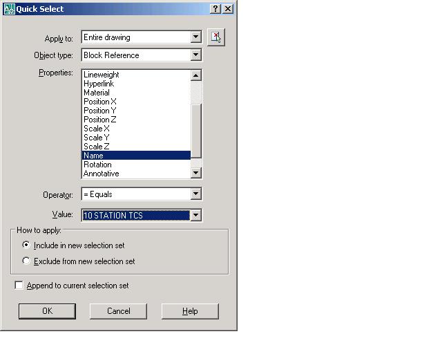

You can use 'quickselect' to locate blocks you want to get rid of. Delete the blocks as you go and then purge the drawing so they are no longer in the database. See dialog box below...

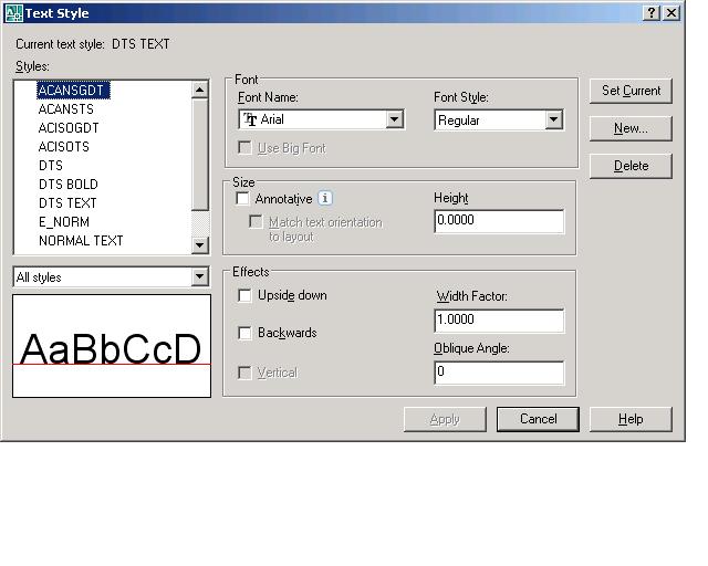

For text styles - make sure all the text you want to keep has the text style applied you want to use then in the styles dialog set current the style you want as your default. Then purge the drawing.

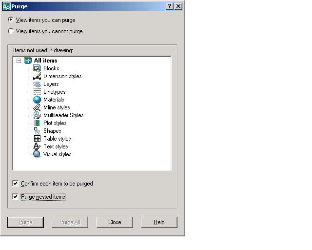

Be sure to select the purge nested items and the confirm box. I like having a fail safe in case I want to make a decision on an item by item basis.
