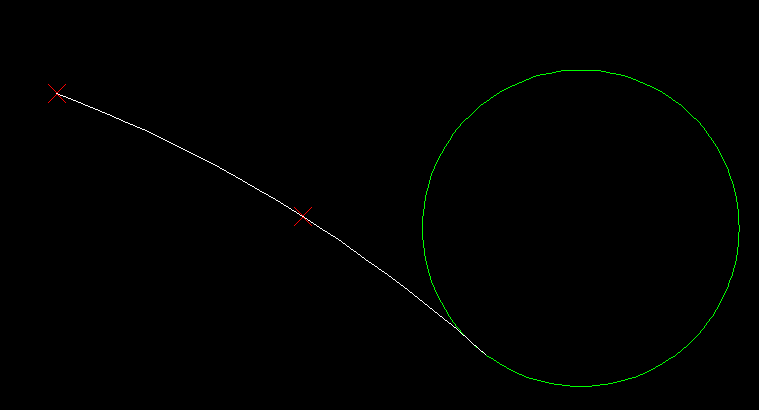

Hi guys, sorry to revive this thread but I've got a similar situation, only I'm trying to draw an arc between 2 fixed points extending tangentially to a circle. See this approximation (though the white arc is intersecting the green circle twice so it's not exactly tangential).
I've tried this and googled for other solutions, but this thread is the closest I could find. Perhaps someone could point me into some direction?
You may have to use CIRCLE with the 3Point option (Node,Node,Tan) and then TRIM it to get the desired result.
Since you are using 2013 you could also use geometry constraints on the Parameter tab.
Thanks yes! That actually works. Strange that it does on circles but not arcs. It's as if when drawing a circle the tan snap calculates a tan'ed curve, while the arc only does a tan line from last point.

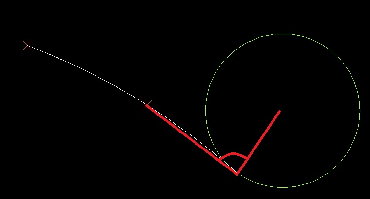

I'm just beating my head around this ... there should be some way to construct this shouldn't there? I mean, straight forward geometry? The circle idea does show that there is a way to calculate it - what it uses internally I don't know (either temporary / phantom geometry or algebraic Cartesian calculation).
Yeah, the 3Point arc method using TAN appears to place the 3rd point tangent to the last pick point, not the arc being drawn. I can see an argument either way.
