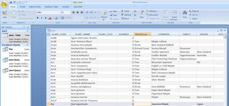

fixo Posted February 20, 2011 Posted February 20, 2011 Upload the screenshot of your Access table and the sample drawing with a few blocks, perhaps I can help ~'J'~ Quote
GegH Posted February 20, 2011 Author Posted February 20, 2011 The idea would be to insert the Plant Code but to identify the code by choosing the Latin name (Plant Name) and/or Common Name, my latin is terrible. I will probably end up filtering/querying the database by Shrub, Tree, Groundcover, etc... but if i understand the code i will do this later. Thankyou so much for your help, i am going nowhere fast. TreeBlockExample.dwg Quote

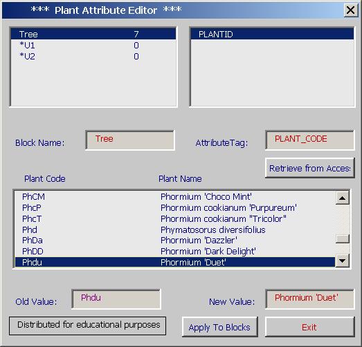

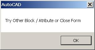

GegH Posted March 1, 2011 Author Posted March 1, 2011 Thankyou for your kind thoughts, it is quite upsetting to see such a beautiful city so desimated and with such a loss of life. I had a go with the App, it seems when i click 'Apply to Blocks' a dialogue box opens telling me to try other block. I did find another command 'GATTE' which is essentially what i need to do: Command: gatte Initializing... Select block or attribute [block name]: Known tag names for block: PLANTID Select attribute or type attribute name: Block: Tree Attribute tag: PLANTID Enter new text: AcBr Number of inserts in drawing = 7 Process all of them? [Yes/No] : NO Select objects: Specify opposite corner: 4 found Select objects: Please wait... 4 attributes changed But rather than typing the new Code, we pick it from the list in your dialogue box. I'm not sure if this makes the task simpler or not. I really appreciate your help with this Quote
fixo Posted March 1, 2011 Posted March 1, 2011 I'm pretty sure you'll restore this nice town and all the buidings you've loved before Not so quick of course, anyway Ok, back to App, what I understand from your explanation: you want to add possibility to change all blocks or just the blocks that you've selected on screen Think in this case we need to drop on form 2 radio buttons for that Am I right? Quote
GegH Posted March 1, 2011 Author Posted March 1, 2011 More often than not it will be selecting certain blocks on the screen. Designers are a flaky bunch who constantly change their minds, and clients tend to not know their minds until you're on site. The radio buttons sound like a great idea. Quote
