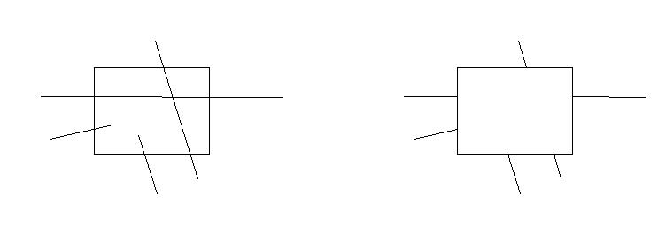

Jack_O'neill Posted February 12, 2011 Posted February 12, 2011 Is something like this what you are trying to do? If so, try the "trim" command. After re-reading your post, I realize now that you said trimming wasn't enough. I don't know of a way to simply erase inside a box without using the "erase" command. One of the lisp gurus might be able to write a custom autolisp routine for you that would combine both commands, but sadly, that's not me. If one of them doesn't come up with something here, try reposting your question in the autolisp forum. Quote

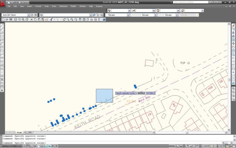

ejmmfc Posted February 12, 2011 Author Posted February 12, 2011 I've atatched an image which shows once you've deleted the date within the box which took an eternity to select using only a rectangle selector your left with all these edges to erase too. Again some kind of command to delete everything within a polyline would be perfect and neat whilst saving so much time. Thanks again Quote
