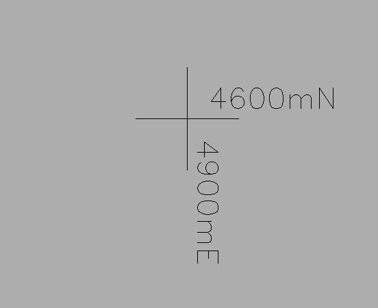

Hallen11 Posted February 11, 2011 Posted February 11, 2011 Hello there, This is my first post so forgive me if it's in the wrong place or something. I've been looking for a lisp routine that draws a survey grid, at user specified intervals, to the exents of my viewports. Or just to a rectangle would do. And if anyone knows of a routine that allows me to zoom my viewports to a model space rectangle, I'd be much obliged. Many thanks for any help offered and if anyone requires further clarification just let me know. Cheers! Quote
eldon Posted February 11, 2011 Posted February 11, 2011 Do you want a grid tick, or something more elaborate? Quote
Hallen11 Posted February 14, 2011 Author Posted February 14, 2011 Thats pretty much what I'm after, eldon. Minus the "m" and with the Co-ords just round edges of the VP. Could you help us out? Quote

alanjt Posted February 14, 2011 Posted February 14, 2011 Why don't you give us an image of exactly what you're working towards. Cool video tip Alan~greg Here's another one I did for a graphic scale. Quote
Hallen11 Posted February 15, 2011 Author Posted February 15, 2011 This is what I'd like the end result to look like With the text round the edges, prefarably with the green highlighting at 50m intervals, all drawn to a user defined rectangle (which I'll be copying and pasting from my viewport). Cheers. Quote

Least Posted February 15, 2011 Posted February 15, 2011 Try this one, no idea who wrote it. I use a different one but I can't post it as it's copyrighted. (defun c:addgrid() (SETVAR "SNAPANG" 0) (SETQ space (GETreal "\n Input Grid Interval :- ")) (setq pt1 (getpoint "\n Pick Bottom Left Corner for Grid :- ")) (setq pt2 (getcorner pt1 "\n Pick Top Right Corner for Grid :- ")) (setq scale (getreal "\n Scale for Grid Information :- ")) (SETVAR "CMDECHO" 0) (SETVAR "ANGBASE" 0) (SETVAR "ANGDIR" 0) (setq csize (* 10.0 (/ scale 1000.0))) (setq X1 (CAR PT1)) (SETQ Y1 (CADR PT1)) (SETQ X2 (CAR PT2)) (SETQ Y2 (CADR PT2)) (SETQ X1A (/ X1 SPACE)) (SETQ X1b (FIX X1A)) (SETQ X1c (- X1A X1b)) (SETQ X1c (* X1c SPACE));remainder (SETQ y1A (/ y1 SPACE)) (SETQ y1b (FIX y1A)) (SETQ y1c (- y1A y1b)) (SETQ y1c (* y1c SPACE));remainder (SETQ y2A (/ y2 SPACE)) (SETQ y2b (FIX y2A)) (SETQ y2c (- y2A y2b)) (SETQ y2c (* y2c SPACE));remainder (SETQ X2A (/ X2 SPACE)) (SETQ X2b (FIX X2A)) (SETQ X2c (- X2A X2b)) (SETQ X2c (* X2c SPACE));remainder (setq x1b (* (+ x1b 1) space)) (setq y1b (* (+ y1b 1) space)) (setq x2b (* x2b space)) (setq y2b (* y2b space)) (setq xarr (- x2b x1b)) (setq xarr (/ xarr space)) (setq yarr (- y2b y1b)) (setq yarr (/ yarr space)) (setq orig (list x1b y1b)) (command "line" (list x1b (- y1b csize)) (list x1b (+ y1b csize)) "") (setq l1 (entlast)) (command "line" (list (- x1b csize) y1b) (list (+ x1b csize) y1b) "") (setq l2 (entnext l1)) (setq yarr (fix yarr)) (setq xarr (fix xarr)) (command "array" l1 l2 "" "r" (+ 1 yarr) (+ 1 xarr) space space) (setq east x1b) (setq inner (/ 1.0 (/ 1000.0 scale))) (setq tsize (/ 1.5 (/ 1000.0 scale))) (repeat (+ xarr 1) (setq texor (list (+ east inner) (- y2 inner))) (setq val (rtos east 2 3)) (SETQ VAL (STRCAT VAL "E")) (command "text" texor tsize "270" val) (setq east (+ east space)) ) (setq east x1b) (repeat (+ xarr 1) (setq texor (list (+ east inner) (+ y1 inner))) (setq val (rtos east 2 3)) (setq val (strcat val "E")) (command "text" "r" texor tsize "270" val) (setq east (+ east space)) ) (setq north y1b) (repeat (+ 1 yarr) (setq texor (list (+ x1 inner) (+ north inner))) (setq val (rtos north 2 3)) (SETQ VAL (STRCAT VAL "N")) (command "text" texor tsize "0" val) (setq north (+ north space)) ) (setq north y1b) (repeat (+ 1 yarr) (setq texor (list (- x2 inner) (+ north inner))) (setq val (rtos north 2 3)) (SETQ VAL (STRCAT VAL "N")) (command "text" "r" texor tsize "0" val) (setq north (+ north space)) ) (SETVAR "CMDECHO" 1) ) Quote
Hallen11 Posted February 15, 2011 Author Posted February 15, 2011 Close enough Least cheers! I think I'll have a little play about with it to see if I can personalise it somewhat. I may even keep on with mine just for the hell of it (if I can be bothered! ) Thanks again to everyone who's helped me out! Quote
Hallen11 Posted April 5, 2011 Author Posted April 5, 2011 I finally got round to finishing my grid lisp! I must admit i'm actually quite proud of it. The code is a bit untidy but the command itself seems to work fine. (And that'll do for me!) So, for those of you who are interested here it is. Any feedback will be appreciated. gridR.lsp Quote
