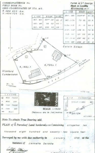

Robert M Posted February 8, 2011 Author Posted February 8, 2011 (edited) I am drawing presently the traditional way u know with T- square,set square etc.. but always hearing about autocad so i went and download the software and then i found a video tutorial of the version i downloaded, so my problem is with drawing up the boundary lines from the surveyor's plan. Edited February 8, 2011 by Robert M Quote

ReMark Posted February 8, 2011 Posted February 8, 2011 OK! We have a surveyor's plan. That's a start. What information is shown on the site plan besides the property line? Can you post a jpg of the surveyor's plan? Quote
Robert M Posted February 8, 2011 Author Posted February 8, 2011 Robert: Great response but it failed to answer a single question. The more information about this project the better we will be able to help you. So you want to draw a site plan and put one of your houses on it? What information do you have so far about the site? yes i have drawing from lands and surveys department of St.Vincent rite,it have on it a Traverse: Line, Bearing, Distance eg. Line: C-B Bearing:217degrees 22feet Distance: 80.98 when put in these values into autocad i am getting very long line which i cant zoom out two see both ends and the degrees i put in is different to what is on the surveyor's plan Quote
SLW210 Posted February 8, 2011 Posted February 8, 2011 Format>Units and change angle to surveyor's units. _UNITS on the command line. Regenall to zoom out or Zoom Extents. Quote
ReMark Posted February 8, 2011 Posted February 8, 2011 Robert: The first rule of AutoCAD is that all objects are drawn in model space at FULL size. If the distance is 12" that what you draw it at. If the distance is 432' then that's what you draw it at. It doesn't matter if you are drawing the eraser at the end of your pencil or a Boeing 777 Dreamliner you still draw it full size. What units are you using? Decimal, Architectural or Engineering? Is North indicated on the surveyor's plan? Do you know how to enter angles in AutoCAD? Quote

Robert M Posted February 9, 2011 Author Posted February 9, 2011 Robert: The first rule of AutoCAD is that all objects are drawn in model space at FULL size. If the distance is 12" that what you draw it at. If the distance is 432' then that's what you draw it at. It doesn't matter if you are drawing the eraser at the end of your pencil or a Boeing 777 Dreamliner you still draw it full size. What units are you using? Decimal, Architectural or Engineering? Is North indicated on the surveyor's plan? Do you know how to enter angles in AutoCAD? My units are in architectural and yes the surveyor's plan indicated the North and do not know how to enter angles in autocad Quote
ReMark Posted February 9, 2011 Posted February 9, 2011 Robert: The link seems to point to your hard drive. There is no way it can be accessed. Quote
ReMark Posted February 9, 2011 Posted February 9, 2011 I can kind of read it but I already see a future problem. There are no ties to either house nor are the zoning setbacks shown. Is a new house being built or is an existing house being renovated? Quote
