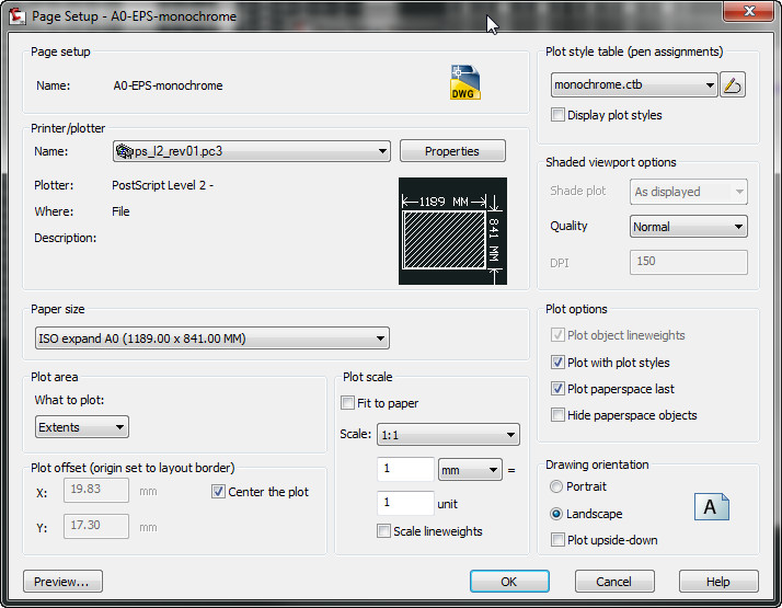

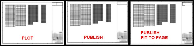

therealjd Posted February 7, 2011 Share Posted February 7, 2011 I created a pagesetup to output to EPS files. Then i have our acrobat server convert them to PDFs. We typically get smaller files than using the DWG to PDF print driver that way. I can run a plot with the pagesetup and it works fine. However, if i use the same pagesetup on the same drawings using the publishing feature, the PDFs generated are cropped on one edge. It's like the whole plot is offset. I have no idea why it's doing this... Any suggestions? I'm using AutoCAD 2009. Quote Link to comment Share on other sites More sharing options...
SLW210 Posted February 7, 2011 Share Posted February 7, 2011 What do you have for Plot Area and Plot Offset? Quote Link to comment Share on other sites More sharing options...
therealjd Posted February 7, 2011 Author Share Posted February 7, 2011 What do you have for Plot Area and Plot Offset? plot to extents, offset is set to center on plot.. Quote Link to comment Share on other sites More sharing options...
SLW210 Posted February 7, 2011 Share Posted February 7, 2011 Have you tried the Fit to paper option under plot scale? Quote Link to comment Share on other sites More sharing options...
therealjd Posted February 7, 2011 Author Share Posted February 7, 2011 Have you tried the Fit to paper option under plot scale? Just tried it, borders are going right to the edges.. i've got sample plots of each one.. plotting w/ the pagesetup.. then publishing w/ the same pagesetup. 3rd one is a modified pagesetup w/ the plot scaled to fit.. (see attachment) Quote Link to comment Share on other sites More sharing options...

therealjd Posted February 8, 2011 Author Share Posted February 8, 2011 First, thanks for the suggestions and some feedback... Glen, I decided to recheck my sheet sizes.. my pagesetup was using an "ISO A0 expanded (841x1189)".. I adjusted the print margins in the file to zero, so i could "print" right to the edges. I decided to change the print margins for the "ISO A0" sheets (portrait and landscape).. Ran the publisher again, and there's no problems now.. So even though my pagesetup specified "ISO A0 expanded", modifying "ISO A0" fixed the problem (!?) So, i'm assuming that when publisher runs, it looks at the printer being used, and picks the first 'same size' sheet that's specified in the pagesetup?? I'm glad it's working. Thanks for the help folks.. consider this case solved! Quote Link to comment Share on other sites More sharing options...
