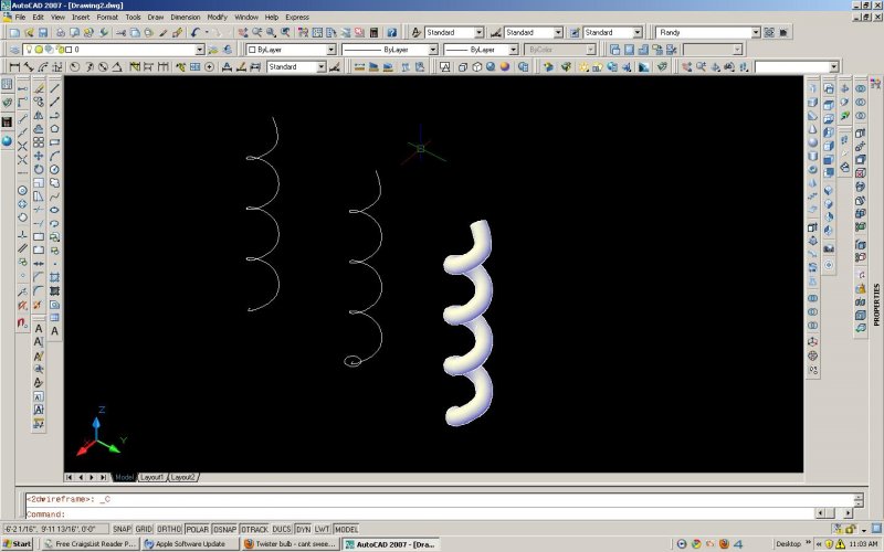

You could try a helix as well, but you should be able to sweep along a spline. Make sure that what you're trying to sweep is perpendicular to the path at the starting point. Here's an example:Example.jpg

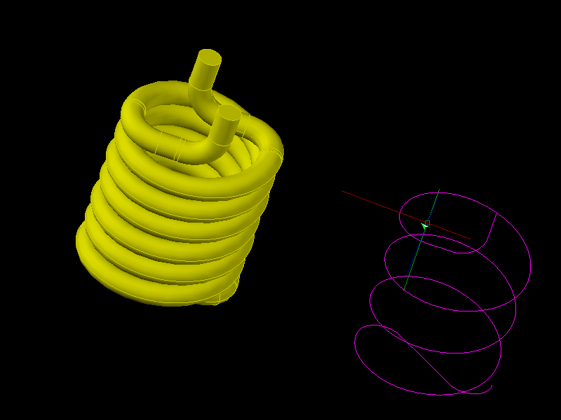

You can get some pretty good results using 2 helix's rotated and 180 and copied. Then manipulating the UCS a litte you can use filleted polylines to make the bends.
This is not a perfect example but it only took a few minutes. You can get a pretty accurate model with a little time.

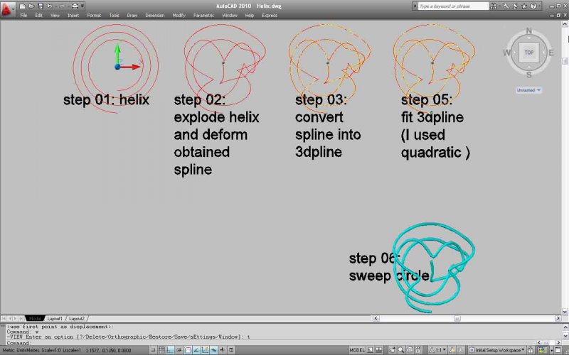

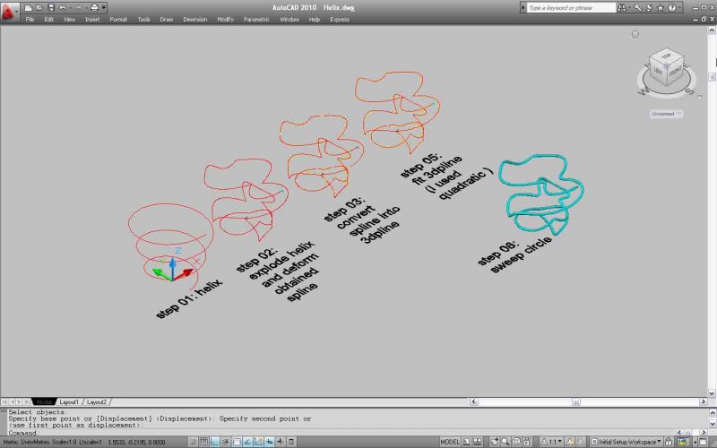

Hello,

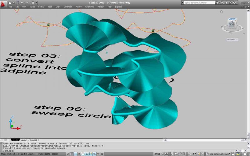

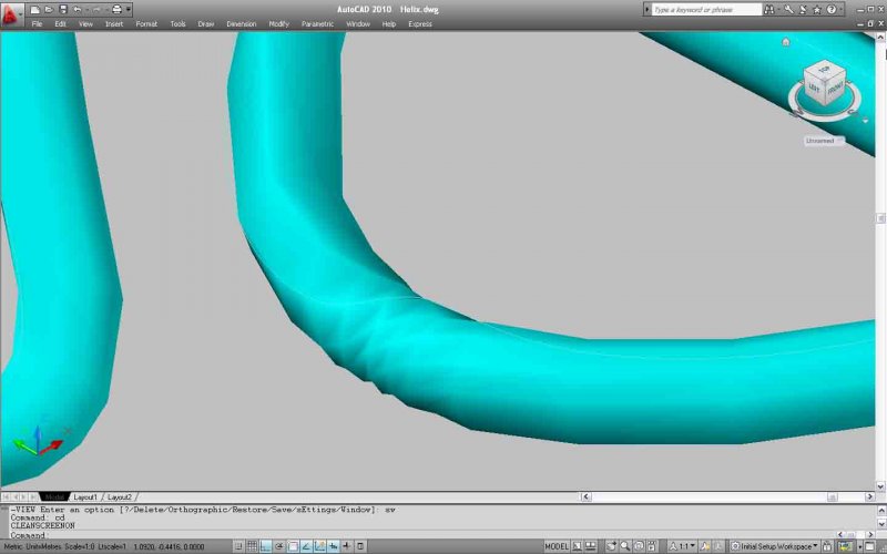

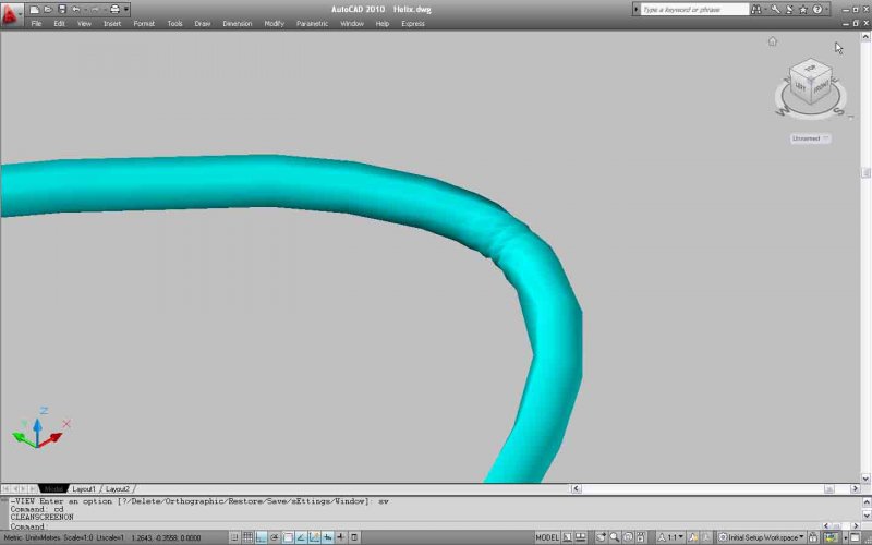

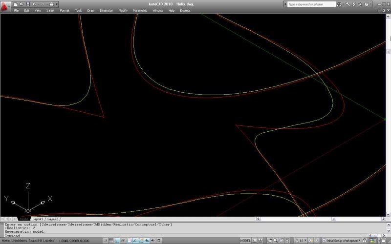

I did an experiment with a helix exploded and converted in spline, and later converted in smoothed 3dpline.
The conversion of spline in 3dpline that eliminates "sharp edges" that prevent the sweep.
However the solid obtained has no a "clean" geometry as shown in the zoom.
Regards,

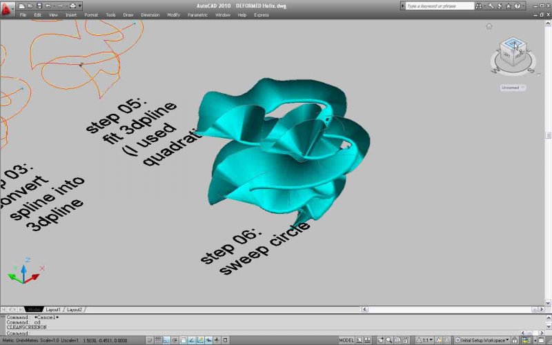

When you use sweep or loft pay attention to the geometries you get.
If they are not "clean" can make you ugly jokes.
When I closed my file, my deformed bulb has become a tropical flower!:shock:
