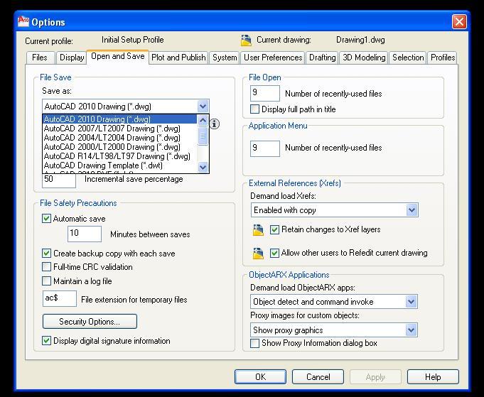

Jack_O'neill Posted January 26, 2011 Share Posted January 26, 2011 is there any software to open the drawing in all version..? because if i draw the drawings in auto cad 2010 version but when i forget to save the drawing in version 2000 then it will not open in 2008/9 version so there must be some software to open this drawing....and thanks in advance.. You can set Autocad to always save down to the oldest version. See below: Quote Link to comment Share on other sites More sharing options...
anil130 Posted February 7, 2011 Author Share Posted February 7, 2011 @jack: many many thanks jack for the prompt reply..the way you are showing me is only open in 2010 version.when you set like this ( 2010 )then you can open only in 2010 version but when you set it in 2000 version then you can open in any version but my question is that suppose i set it in 2010 version and i had to open in another computer but there is different version at that time it will not open because it will open only in 2010 version..but i think MSASU is right and from that we can open in any version and iam going to that one.... Thanks in advance.. Quote Link to comment Share on other sites More sharing options...
