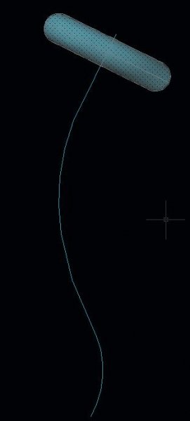

I am looking for a 3D copy through a spline or a array through a spline or pline.
i have created a object at the tip of the pline and now i want to copy it throughout the spline
just imagine i am trying to create a curve stair, I have create a curve and a 3d rectangular piece at the top of the curve and now i want to copy it throughout the curve.
thanks in advance

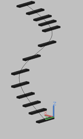

Have you tried the MEASURE or DIVIDE commands? You need to save your object as a block first, then either a specific number of copies with DIVIDE, or copies at a equal distance from one another with MEASURE.
my pictures
took about 3 minutes,
no exact measurements
in autocad
TURN ON OBJECT SNAP Make sure nearest is selected
left click the object to select
then right click and select move, define the move point as the objects exact center if you do not know where thats at create splines through the object you should know what im talking about to find the objects center
and then use the center of the object as the move point and move it along the spline
with object snap and nearest active you will be able to move any object along a spline
though im sure you will need to copy selection and place multiple along the spline

my mistake nearest not extension
