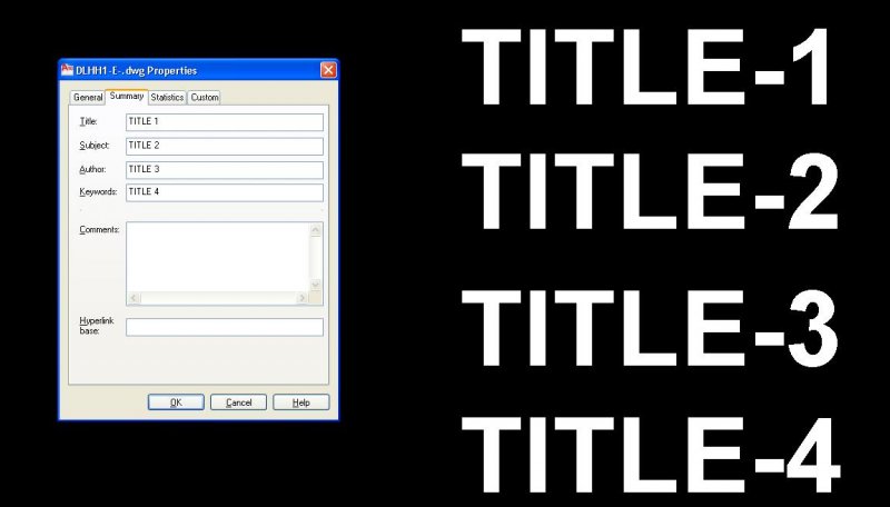

kam1967 Posted January 24, 2011 Share Posted January 24, 2011 Hi guys, I'm not sure if you have done this before. I tried to search, but it does not appear that anyone's run into this trouble before. I am trying to use the titleblock information with tags TITLE-1 through TITLE-4 to fill out the drawing property on the Summary tab, starting from the Title, Subject, Author, Keywords matching with TITLE-1, TITLE-2, TITLE-3 and TITLE-4 respectively. See attached. Is it possible to get that done here? Thanks in advance. Quote Link to comment Share on other sites More sharing options...

kam1967 Posted January 25, 2011 Author Share Posted January 25, 2011 Thanks, Lee. Although, I'm not sure if I made myself clear. I was inquiring to see if anyone has a routine to extract and populate the Dwgprops dialogue with the Titleblock info with the following attribute tags: TITLE-1, TITLE-2, TITLE-3 and TITLE-4. So assuming that there is a block called TITLEBLOCK which contains the TITLE1-4 attributes. I'd like to be able to transfer that information directly into the drawing property as shown in the jpeg. Hope I made myself clear this time. Quote Link to comment Share on other sites More sharing options...

kam1967 Posted January 25, 2011 Author Share Posted January 25, 2011 (edited) Ah, I ran it and got Autocad to list those drawing properties. Thanks, Lee. So is there a way that I could update the information in the summaryInfo from the titleblock attributes through lisp? How could I assign variables in the summaryinfo to match with the attributes found in the titleblock itself? Any help would be greatly appreciated. ; Title = "TITLE-1" ; Subject = "TITLE-2" ; Author = "TITLE-3" ; Keywords = "TITLE-4" This is a lisp that I need to modify to make it work, however, I'm not sure how to ask it to take these attribute values from TITLEBLOCKA and update the dwgprops summary tab this way. ;;;initialize DWGPROPS if it does not exist ;;;this is stripped down, you can add more to it, if you wish (defun dp:init () (if (and (zerop (getvar "DWGTITLED")) (not (dp:get))) (progn (setq ;dp:Title (val 2)<-could be extracted from Title block via LISP ;dp:Subject (val 3) dp:Author "Your Organization" ;dp:Keywords (val 7) dp:RevisionNo "0" dp:Cust0 (val 300)<-1st Custom Property dp:Cust1 (val 301)<-2nd Custom Property ; ) (dput) (setvar "CMDECHO" 0) (command "_.QSAVE") (setvar "CMDECHO" 1) ) ) (princ) );dp:init (dp:init) Edited January 18, 2018 by SLW210 Added Code Tags Quote Link to comment Share on other sites More sharing options...
pBe Posted January 25, 2011 Share Posted January 25, 2011 How could I assign variables in the summaryinfo to match with the attributes found in the titleblock itself? Any help would be greatly appreciated. ; Title = "TITLE-1" ; Subject = "TITLE-2" ; Author = "TITLE-3" ; Keywords = "TITLE-4" Try this (defun c:GrabTBValue (/ dwg sum ths_blk cnt func strVal) (defun Tag_value (tagname / lay_t attr tag ) (vlax-for lay_t (vla-get-layouts dwg) (vlax-for p (vla-get-block lay_t) (if (and (= (vla-get-objectname p) "AcDbBlockReference") (= (strcase (vla-get-effectivename p)) (strcase ths_blk))) (if (and (= (vla-get-hasattributes p) :vlax-true) (safearray-value (setq attr (vlax-variant-value (vla-getattributes p) ) ) ) ) (foreach tag (vlax-safearray->list attr) (if (= (strcase tagname) (strcase (vla-get-tagstring tag))) (setq strVal (vla-get-TextString tag)) )) ) ) ) ) ) (setq dwg (vla-get-activedocument (vlax-get-acad-object)) sum ( vla-get-SummaryInfo dwg) ths_blk [color=blue]"TITLEBLOCKA"[/color] cnt 0) [color=blue];<---your blockname[/color] (foreach b '("title" "subject" "author" "keywords") (setq func (eval (read (strcat "vla-put-" b)))) (Tag_value (strcat "TITLE-" (itoa (setq cnt (1+ cnt))))) (func sum strVal) ) ) Quote Link to comment Share on other sites More sharing options...

Lee Mac Posted January 25, 2011 Share Posted January 25, 2011 I might approach it this way: (defun c:UpdateSummaryInfo ( / sum tags ss ) (vl-load-com) ;; © Lee Mac 2011 (setq sum (vla-get-SummaryInfo (vla-get-ActiveDocument (vlax-get-acad-object)) ) ) (setq tags '( ("TITLE-1" . title) ("TITLE-2" . subject) ("TITLE-3" . author) ("TITLE-4" . keywords) ) ) (if (setq ss (ssget "_X" '((0 . "INSERT") (66 . 1) (2 . "TITLEBLOCK")))) (mapcar (function (lambda ( attrib / prop ) (if (setq prop (cdr (assoc (strcase (vla-get-TagString attrib)) tags))) (vlax-put-property sum prop (vla-get-TextString attrib)) ) ) ) (vlax-invoke (vlax-ename->vla-object (ssname ss 0)) 'GetAttributes) ) ) (princ) ) Quote Link to comment Share on other sites More sharing options...
Lee Mac Posted January 25, 2011 Share Posted January 25, 2011 pBe, Just offering my opinion, ignore it if you like: The algorithm that your code implements is extremely inefficient (and I cannot stress that enough) - let me explain why: For every property, your code iterates through, not only every block in the drawing, but every object in the drawing. Hence you are iterating through every single object in the drawing, four times over. Furthermore, you are also iterating through all the attributes for every attributed block with the name specified in the drawing - also four times over. Notice in my approach, I only iterate through the attributes of a single attributed block once. The key point I make and the most effective way to increase efficiency in a program is to greatly minimise the number of times the program iterates through information (once if possible). Lee Quote Link to comment Share on other sites More sharing options...
