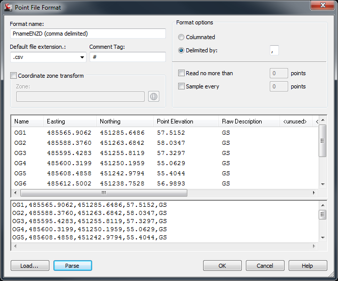

sinc Posted February 5, 2011 Posted February 5, 2011 You can create a Point File Format to import your data. Just copy the existing "PNEZD (comma delimited)" Point File Format, then modify it so that the first field is Point Name instead of Point Number. The following image is an example. I also loaded your sample data into the dialog, so you can see how it gets parsed. Just keep in mind that every Cogo Point in Civil 3D must also have a Point Number, so C3D will also automatically assign Point Numbers to these points as they are imported. So you may want to adjust your "next point number" prior to importing your data. Quote
