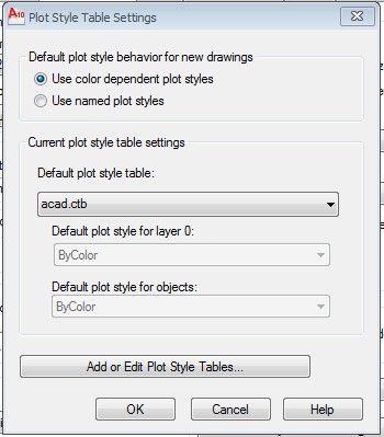

Nexter Posted January 23, 2011 Posted January 23, 2011 Hello guys I have a strange issue with dimensions in my autocad 2010. They are all set to GREEN in Dimension Style Manager dialog box, but when I plot drawings they turn to BLUE, everything, lines, text, arrows... I've tried to put them all in a some green-colored layer while drawing, then change the color to some other in Dimension Style Manager again, and so on... but they are just staying BLUE, no matter what I do. Only when I use STANDARD or ISO-25 they plot black as they are supposed too... It's driving me crazy, can somebody help, please... Thank you. Quote

Nexter Posted January 23, 2011 Author Posted January 23, 2011 Hi ReMark, yes I've checked a little and tried a few things, not much as I'm not quite sure what I should do... Quote

Nexter Posted January 23, 2011 Author Posted January 23, 2011 Perhaps I should be back on Plot Style Table Settings and try to setup things better. Quote
