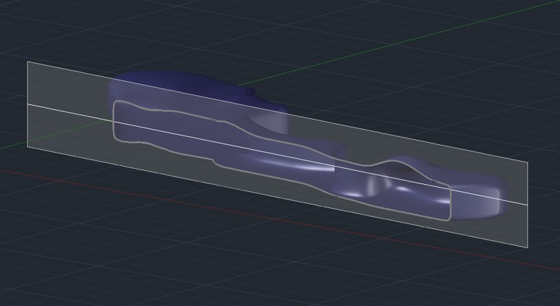

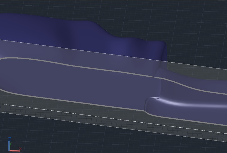

SEANT Posted January 23, 2011 Posted January 23, 2011 That will be a rather complex procedure for AutoCAD. A couple of suggestions, perhaps: Move the model closer to the WCS origin. It looks like the shape will only support a rather small shell distance ( The process may need to be sub divided to reduce the complexity of any one operation. Here is an image of a small sample. Quote

SEANT Posted January 23, 2011 Posted January 23, 2011 I started simple by using only two of the mesh shapes. Those shapes, once solidified and unioned, would not SHELL with a thickness of 1, but did okay with a thickness of .1. Task Manager spikes rather dramatically with the operations, though. It is not hard to imagine hitting the ceiling if too many shapes are processed simultaneously. Quote
basshead Posted January 23, 2011 Author Posted January 23, 2011 i tried again, but it s still telling me 'no solution for a vertex'. i also tried the process by creating a simpler mesh, converting it into a solid, and applying the shell function with 0.15m thickness, but the same statement is displayed below. i think the problem is when converting the mesh to a solid, because when i make multiple solid primitives, unionize them and apply shell, it works. i cant understand what i m doing wrong. and what do you mean by "using only two of the mesh shapes"? to create a shell around the whole model, dont you have to unionize all the meshes and then apply shell? or is there another way? Quote
SEANT Posted January 24, 2011 Posted January 24, 2011 It doesn’t look like AutoCAD will shell some of those shapes with .15 but can at .10. Without a doubt this type of modeling is the most taxing on a system. I’d be somewhat surprised if any setup could union everything together and get AutoCAD to shell it properly, even at .10. One procedure to break it down to smaller steps might be to CONVTOSOLID on the meshes, Run INTERFERE on two neighboring lumps and keep the resulting solid, SHELL at whatever thickness the operation will support, then SUBTRACT the interference solid from the shells. That method would leave a bit of a step at the junction’s inside but that may not be a problem depending on what you are trying to do. Quote
