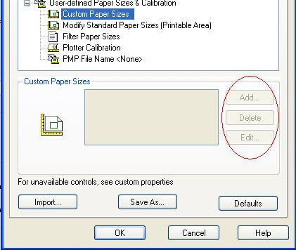

BlackBox Posted January 19, 2011 Share Posted January 19, 2011 Does anyone know how this feature (add custom paper sizes) can be disabled? Better yet, can someone tell me how to re-enable it!? I am trying to print a long roll to one of our multi-roll printers, and can no longer customize the PC3 file's 'custom paper sizes': Edit: 'Custom Properties' does not provide this missing functionality either. I have full rights to both create/modify PC3 files locally and on the server. We've just undergone a migration to all new systems, and all of our custom paper sizes are missing. In the past, when we get a new printer, etc. I've gone into the PC3 and simply created/modified what we need, saved the PC3 and moved on. Easy. This is really frustrating, and IT has no idea what may have caused this loss of functionality. Edit: This 'loss' applies to everyone enterprise-wide, no less, and not just on my machine. Any help would be most appreciated. Quote Link to comment Share on other sites More sharing options...

BlackBox Posted January 19, 2011 Author Share Posted January 19, 2011 I assume so, as IT was responsible for the migration, but how can I be sure? Also, to clarify, the default (built-in) custom paper sizes that usually show up with multi-roll printers are present in all but this particular device (HP4500)... all of our HP1055's etc have the custom paper sizes which can be modified via 'Custom Properties' and saved out to individual PC3 files (one for each roll, etc.). As it goes with many others, we had the functionality pre-migration, and lost it post-migration. Quote Link to comment Share on other sites More sharing options...
JPlanera Posted January 19, 2011 Share Posted January 19, 2011 Well, if you can not add custom paper sizes, it is safe to assume it has been set up as system printer. In that case, you should be able to make your adjustments via Control Panel in windows.... Quote Link to comment Share on other sites More sharing options...
BlackBox Posted January 19, 2011 Author Share Posted January 19, 2011 (edited) No luck there either, as both of these are unsuccessful: Control Panel > Printers and Other Hardware > Autodesk Plotter Manager > Plotter Configuration Editor > Device and Document Settings tab Control Panel > Printers and Other Hardware > Printers and Faxes > Properties > Printing Preferences... > Paper/Quality tab Edited January 19, 2011 by BlackBox Typo Quote Link to comment Share on other sites More sharing options...
JPlanera Posted January 19, 2011 Share Posted January 19, 2011 As an experiment, in the PLOTTERMANAGER, walk through the add plotter wizard and see if you may be able to add the printer yourself without those information technology know-it-alls!!!! Quote Link to comment Share on other sites More sharing options...
BlackBox Posted January 19, 2011 Author Share Posted January 19, 2011 PLOTTERMANAGER opens a Windows Explorer directory, and there is no 'add printer' option to the left side panel, nor from the menu pulldowns. IT says they just copied our previous Printer drivers, and queues, then renamed them. They have no idea why not even an admin can use the grayed out buttons shown in the OP. Quote Link to comment Share on other sites More sharing options...
JPlanera Posted January 19, 2011 Share Posted January 19, 2011 Check out the screencast. Maybe it can shed some light http://screencast.com/t/q2wIo2deiIYu Quote Link to comment Share on other sites More sharing options...
BlackBox Posted January 19, 2011 Author Share Posted January 19, 2011 Thanks for the link, it was informative. I shared it with IT, when my attempts were still unsuccessful... They're looking into it. Quote Link to comment Share on other sites More sharing options...
