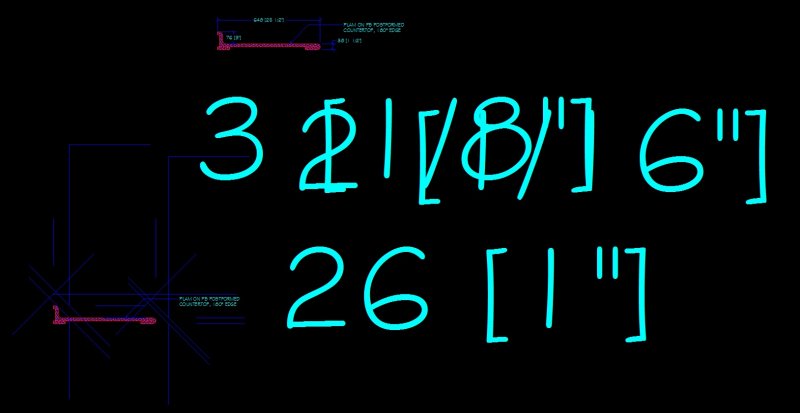

MDrawings Posted January 18, 2011 Posted January 18, 2011 (edited) Thanks for taking the time to read my question. I've made a library of fancy dynamic blocks complete with Annotative dims right in the block to save time! All the blocks are created in imperial. I now want to use the same blocks in a metric drawing. But when I insert the blocks the dimensions come out 25.4 too big! I also have multi leaders in some of the blocks and they work, scaled perfectly! When I check the Annotative dim style all the spacing, arrow sizes and such are proper size inside the metric drawing. It seems as though the inserted block is not inheriting the properties of the Dim style with the same name (simply Annotative), but the multi leaders are? I've been kicking myself for days over this, what am I missing?? Autocad 2010 Please help. Thanks in advance! Edited January 18, 2011 by MDrawings added version Quote

MDrawings Posted January 19, 2011 Author Posted January 19, 2011 ok screen shot attached. (I think) The top is what it needs to look like. The bottom is what I get when I insert the block. And I actually got the top result by exploding the block I inserted... :/ But as you can see the multileader is correct, just the dims are out of whack. I know my dim scale isn't set right, I just want you to see my issue. Quote
JPlanera Posted January 19, 2011 Posted January 19, 2011 Well, it seems the issue is only with your style..... Everythign else is fine. is your style annotative? What is your MODEL scale set to? Is annotative needed? Try the proccess again without it. Quote
MDrawings Posted January 19, 2011 Author Posted January 19, 2011 You're right! I didn't think of it earlier but I have the same name dimstyle (Annotative) in each of my metric and imperial drawings. So because I already have the Annotative dimstyle set in my metric drawing Autocad is doing it's automatic conversation of the block by multiplying everything by 25.4, including all the text sizes, arrow sizes, gaps and such in that dimstyle of the same name... So when I explode the block, it's removing that automatic scaling of the dimensions and it appears correctly... make sense? Something so simple, yet caused me headaches for days... NOW who's pride is hurt? I feel like an idiot now. Many thanks for your help JP, greatly appreciated. Quote
