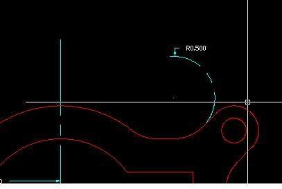

Hey all i am in and Autocad class and when i try to dimension a fillet i get this,
Now i have searched and tried the dimoverride command and change dimse1 to on it still doesnt help, all i want to do is move the leader to the inside of the fillet so it doesnt clutter the drawing, BTW i am running Autocad 2008. Thanks for your help.

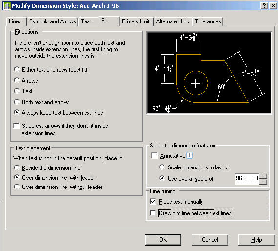

Works Excellent, i appreciate your help!
Brad
Why's the overall scale set to 96.00000 in that example kwortman?
Because that is the default setting for Aec-Arch-I-96 when the drawing is set to 1/8" = 1'-0" scale Out Of The Box. Just like it is set to 12.00000 when the drawing is set to 1" = 1'-0", Strix
I have found with these settings, that the linear dimensions do not work properly and you are required to move the dimension text.
Brad

You can choose to not have the text placed manually within the dimension style
