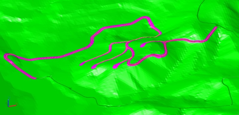

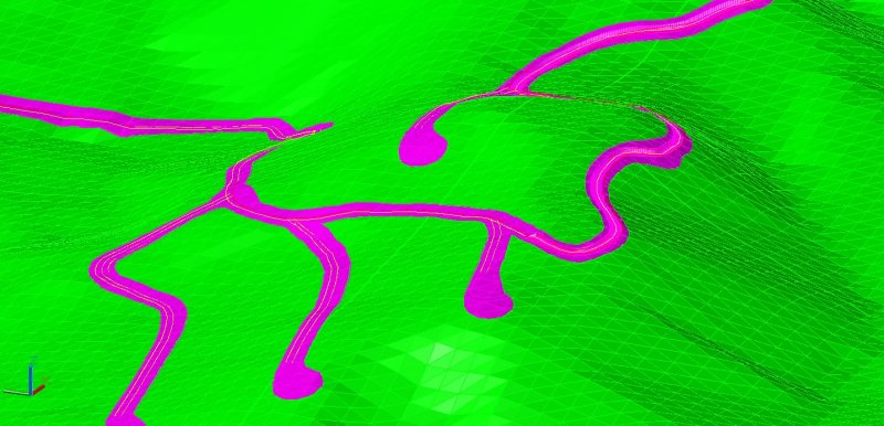

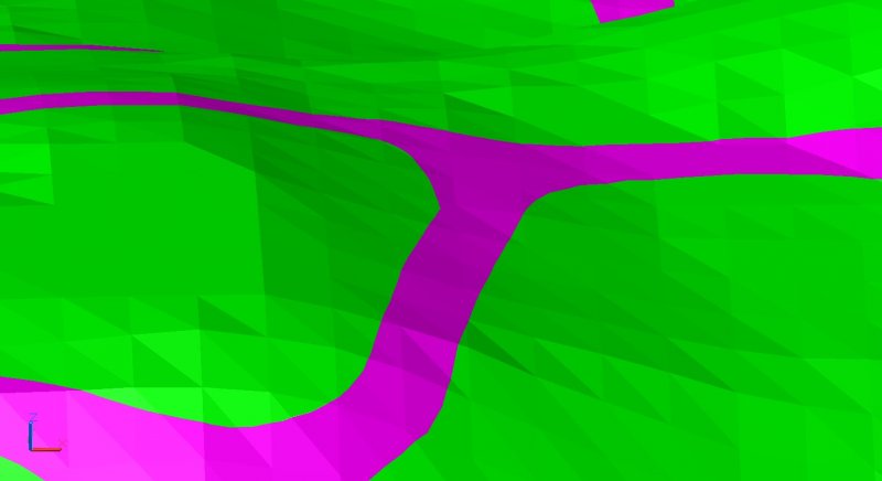

I need to make a road for a 3D model. I have a surface I made with drape command, using the contours from the project. It's a solid. I have the road projection on a plan view. I just want to drill the surface of the solid and make an even surface for the planed road. See attached images.

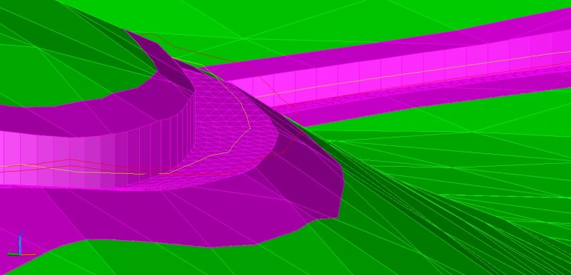

I tried the sweep command to make a solid that can be used to subtract the terrain's surface but unfortunately (that solid produced with the sweep command) it's twisted in a way I can't control to make an even surface, I mean, at least with a minimum slope angle. The command Sweep, at certain point twisted too much the solid or it won't make the surface at all.
I tried 3d Civil, very complicated work flow and certainly I don't know nothing neither of engineering nor of the terminology used there but I tried to learn and see if there was something I could use. I learned to make the surface with the contours, the profile, the assembly, the corridor, the grading, the break lines but what I couldn't make was the hole into the surface. Something that fills and cuts the surface.
Someone knows how to make Autocad cut and fill the 3D surface?
