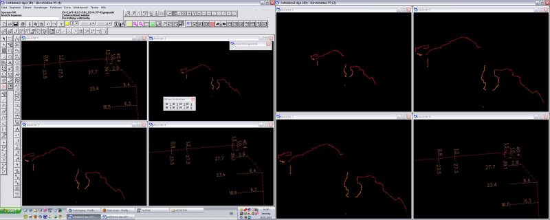

MicroStation has the option to open a second application window. It has as standard 8 further windows that can be opened, usually 1 to 4 in the first application window and 5 to 8 in the second application window. There is a window activation panel with eight check boxes, checking a box opens the window.
These windows are known as viewports in AutoCAD. In AutoCAD you can't have two application windows as in MicroStation.

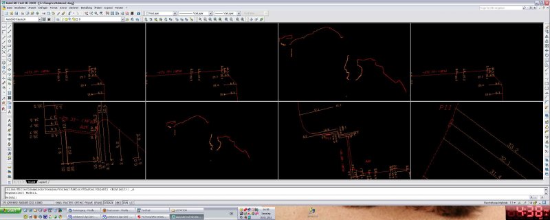

The nearest that you will get is by a workaround but its nothing near as comfortable as in MicroStation. I take it you have two monitors. Re-size AutoCAD over the two monitors, and create two viewports, go into each viewport and create a further four viewports. Then you get the configuration below.
If you don't want 8 viewports you can create as many as you need by varying the procedure shown here.
As far as I know, it is not possible to manually change the size of the viewports in AutoCAD as you can the windows in MicroStation.

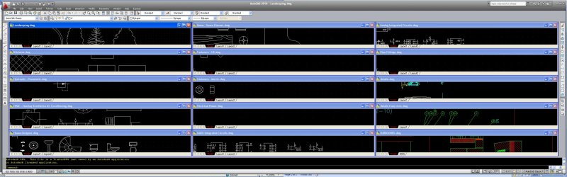

Ok, I understand what you are saying now. And the answer is yes, you can do that in AutoCAD, but it doesn't look quite a neat as Microstation does it. In the pic below, I have 15 drawings open at the same time. To manually change the size of the windows, just drag the edges around.
I think what got us both confused is the different definitions of the term "viewport". In AutoCAD, viewports will give you different views of the same drawing. If you want more than one drawing open, you do that in different "windows". This is called "tiling" the windows.

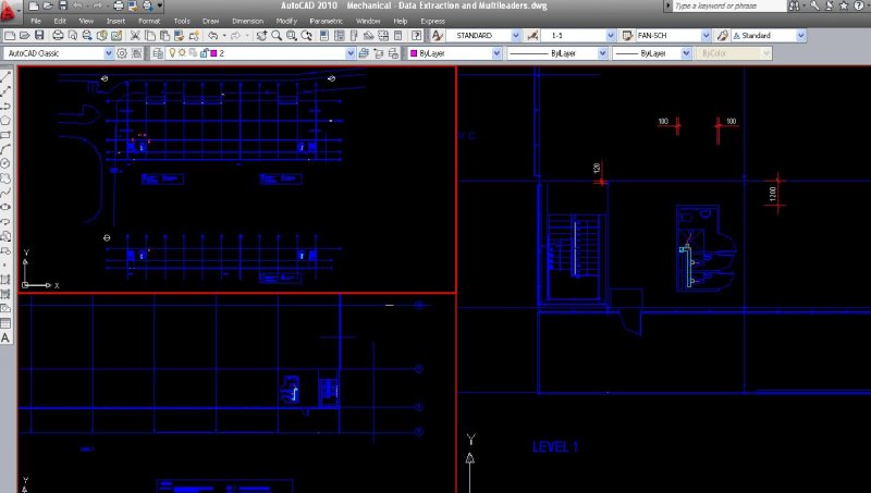

This is an example of 3 viewports looking at the same drawing:

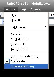

If you get more than 2 or 3 drawings open at once, it becomes far easier to maximize one of them, and then switch between them as needed. One method for doing that is by using this menu:
This menu is also where you tile the windows if you wish, lock thier positions and an assortment of other options.

To activate a pane, just click once inside it. You can move or copy objects from one pane to the other very easily using the AutoCAD Copy or Move command. Just remember to set the base point in the “source” pane, then click once in the “destination” pane to activate it, then click to set the destination point (AutoCAD calls this the “second point”) in the second pane.
