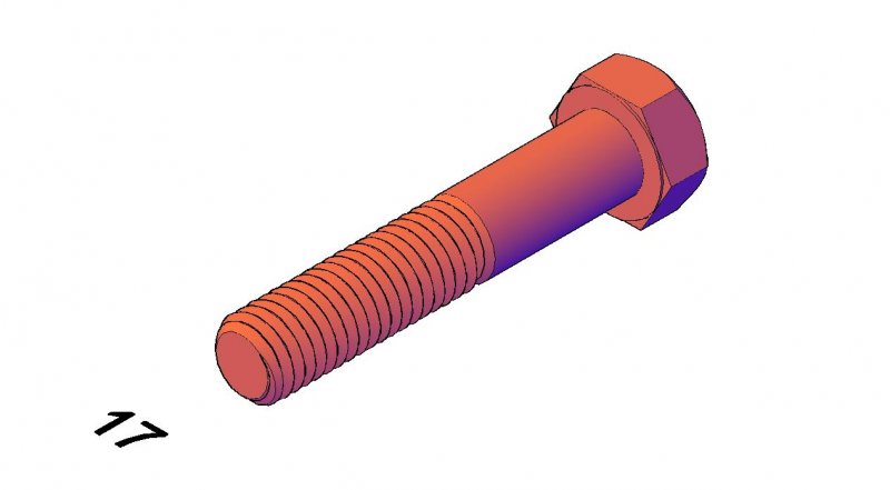

havox07 Posted January 14, 2011 Posted January 14, 2011 I am in a mechanical design class in highschool and am having trouble drawing bolts and pipe thread for out assignments, We have to make the threads realistic not like just lines on the bolt. I am pretty much done all the drawings except for the bolts and pipe threads on each drawing, any help would be greatly appreciated on how to draw these, Examples of what I have to draw: 5/18 18UNC x 1 1/4 Capscrew, 37/64 Drill, 3/8 NPT. Thanks! Quote

SLW210 Posted January 14, 2011 Posted January 14, 2011 Try looking at the bottom of the page here for this.... [ATTACH]25766[/ATTACH] Quote
ReMark Posted January 14, 2011 Posted January 14, 2011 The three most referenced tutorials about drawing a 3D threaded bolt can be found by first clicking on this. http://www.cadtutor.net/forum/showthread.php?51078-Links-to-tutorials-about-3D-bolts-screws-and-threads.&highlight=threaded+bolt I don't believe any of the similar threads shown in the above image cover how to draw a 2D threaded bolt. That is why I included the reference books list. Quote
ReMark Posted January 14, 2011 Posted January 14, 2011 Instructions for drawing a 2D bolt can be found here. http://www.cadalyst.com/cad/autocad/how-draw-good-looking-bolts-from-trenches-tutorial-11188 Quote
