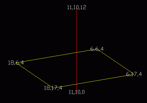

Here's one that is proving to be a bit tougher than I initailly thought it to be:
In plain autolisp ( no vl, vla, vlax, vlaxr.....)
Does the red line intersect inside the yellow rectangle
Given:
The 4 points of the yellow rectangle are always coplaner
The 4 points always form a rectangle
The rectangle is not always WCS
The red line is always predindicular to the the yellow plane
return nil if the red line is:
outside the rectangle
totally above the rectangle
totally below the rectangle
Return T if the any part ( 3D ) of the red line intersects the plane
-David

A query ... is the rectangle's 4 corners always on the same plane? I.e. placing a UCS on 3 of them you can change the 4 lines into a single LW Polyline? If so this is merely difficult maths, if not it would become rocket science.
Notice the hint: use UCS to obtain new values for the 6 points through the trans function.
Yes, the yellow lines are always coplaner.
I don't see how an LWPOLYLINE would help....
I can make a UCS 3PT from the rectangle. I can then find the intersection of the translated line points with the current UCS, but it still doesn't tell the relationship to the rectangle.
Thanks! -David
This will return the intersection between the Line and the Plane (should the line not be parallel to the plane):

From there you just need to determine whether the returned point lies inside your rectangle in the plane...

Wow. Had to step out for a bit. I'll dig into these today Thanks! -David
Some simplifications ( mainly for me )
  1. Set UCS to WCS
  2. Make a UCS for any 3 WCS translated rectangle points
  3. Translate WCS Line points to the current ( rectangle ) UCS
  4. If the Line Z axis goes thru 0.0 then there is an intersection
  5. If an intersection exists, if any angle from the intersection point to any corner of the rectangle is > pi, then the intersection point is outside the rectangle
I might go back to > test to see if the point is in the box. I'd have to test the translations more to be comfortable with it.
irneb, we are convoluted in a similar method.
Lee, The math was a bit over my head.
Thanks -David
Apologies, I should've commented it :oops:

Lee,
Thanks for the description. You're a lot further along in school than I made it or ever wanted to.
I'm getting a false positive:
(prin1
 (LineInRectangle-p '(14 4 5) '(25 4 5) '(2 2 4) '(2 10 4) '(2 10 14) '(2 2 14))
-David
I'm getting a false positive...
Ah yes, my current code assumes an infinite line -
I've updated the code to add an 'onseg' argument to my IntersLinePlane function:

(defun unit ( v )
 ( (lambda ( n ) (if (equal 0.0 n 1e-14) nil (vxs v (/ 1.0 n)))) (norm v))
;; Vector x Scalar - Lee Mac 2010
;; Args: v - vector in R^n, s - real scalar
(defun vxs ( v s )
 (mapcar '(lambda ( n ) (* n s)) v)
;; Vector Dot Product - Lee Mac 2010
;; Args: u,v - vectors in R^n
(defun vxv ( u v )
 (apply '+ (mapcar '* u v))
