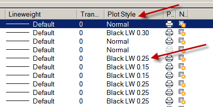

In the layer manager you should see the plotstyle column and in the column there should be plot style names and not grayed out names like Color_2, etc.

After I use the CONVERTPSTYLES command, I always have to save the drawing, close it and then re-open it to get the plot styles to kick in; if I don't re-open I am using STB but my machine will not recognize it.
I have never had that happen, maybe it is a Civil 3D thing.
