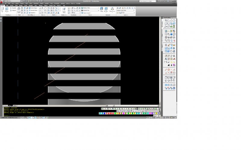

Hi there,
I have a strange problem:Untitled2.jpg
I hope you can see the picture? Does anyone know how to fix it? It only happends when I am in a isometric view. It doesnt matter if I'm in 2d wireframe or another visualstyle... Another strange thing is that we have 2 settings of autocad. We have a 2d setting and a 3d setting. In 2d, I dont have any display problems when I look at my 3d-drawings.... It only happends in the 3d enviroment. I've compared the options-settings and there is no huge difference in display settings or whatever....
Please help me! :oops:

Have you tried turning hardware acceleration off?
What are we looking at here by the way?
What visual style are you using? Conceptual?

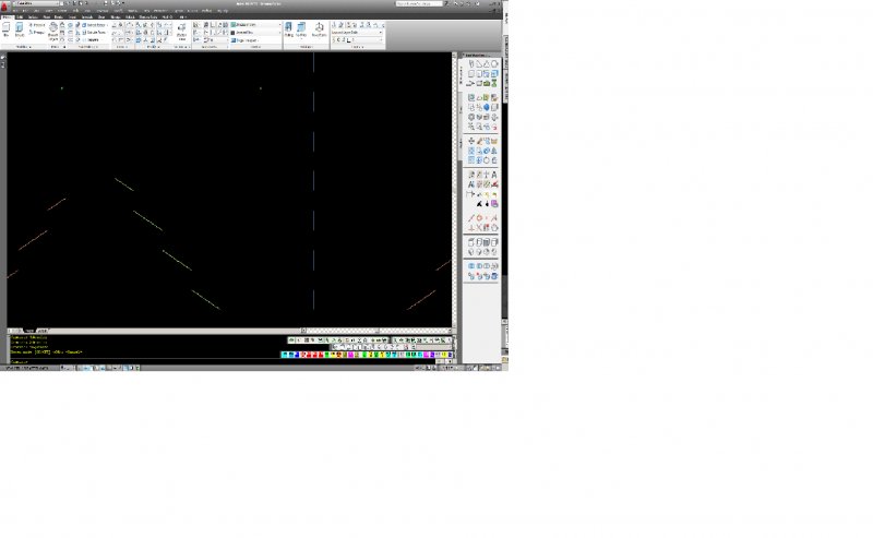

I tried turning it off... It's fixed... but then I had a problem with ehm... how do I say this.... Sticky crosshairs... When I move my crosshairs over the drawing, I get a 1000 crosshairs and the display isnt refreshed. I restarted AutoCAD en now it's ok.... (thanks for now!!! ;))
I was looking at a cylinder. Every visual style had the problem. From 2d wireframe to realistic and from conceptual to sketchy :P
