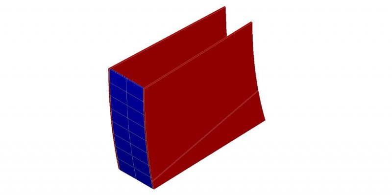

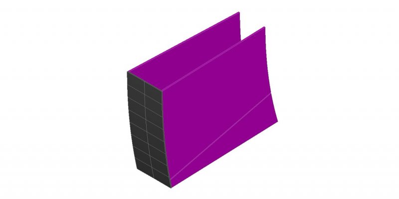

CiCAD Posted January 11, 2011 Posted January 11, 2011 Ive Attached DWG can someone please tell me how to slice along arc surface i would like to slice away the purple panel and have the grey panel run through Please Help you will have to explode the purple block first 3D Help.dwg Quote
ReMark Posted January 11, 2011 Posted January 11, 2011 What are we looking at? Where do the purple and grey panel meet? You have three layers. They are "0", Material - Aluminum, and Material - Poly. You have at least one block named "3d Panel". Quote
CiCAD Posted January 11, 2011 Author Posted January 11, 2011 See If this makes more sense 3D Help2.dwg Quote
ReMark Posted January 11, 2011 Posted January 11, 2011 (edited) See if you can answer the questions put to you. What do you mean by "this panel to run through?" Through what? Or is it that you want one continuous panel in the front and not two? Something about the front grey panel on the right, at the bottom, doesn't look right. The geometry appears to be off. Alright, the purple panel is sliced at the edge where it meets up with the grey panel. Please answer the two questions I asked on line 2 of this post. Hurry up. A snowstorm is coming and I've got things to do. You got 5 minutes from now: 10:52 p.m. GST. GO! Edited January 11, 2011 by ReMark Quote
CiCAD Posted January 11, 2011 Author Posted January 11, 2011 grey panel flush runs past purple panel to be flush at surface where as purple panel stops short of grey panel 3D Help3.dwg Quote

ReMark Posted January 11, 2011 Posted January 11, 2011 Front panels sliced per your basic plan view and flush with the inside face of the two side panels. Quote
elingeniero Posted January 11, 2011 Posted January 11, 2011 It's as clear as mud. You'll note that in the first post above the OP indicates he wants to slice the purple panel yet his drawing shows the grey panels being sliced. Which would you go by? He wasn't clear. Slice the purple panel to stop at the grey panel. As for the grey panel, he wants it to be extruded following the shape of the purple panel. Edit: Wow that was fast Quote
ReMark Posted January 11, 2011 Posted January 11, 2011 The same panels but the opposite condition. The side panels stop flush with the back of the front panels. So it proves it can be done both ways. If there is another condition the OP wanted he'll have to do a better job of explaining. Quote
ReMark Posted January 12, 2011 Posted January 12, 2011 CiCAD: Which image, if any, that I posted satisfies the condition you were attempting to achieve? Did you complete the task yourself yet? Please update us. Quote
CiCAD Posted January 12, 2011 Author Posted January 12, 2011 slice of life 2 is the result i am looking for how do i do it is slice the correct command? Quote
ReMark Posted January 12, 2011 Posted January 12, 2011 The SLICE command was used in both instances. I would have preferred duplicating some geometry and doing a Subtraction and then substitute some objects but the geometry at the front (bottom) of your object is a bit out of whack. I did not notice it until I zoomed in for a much closer look. I did it by borrowing a piece of the geometry from one of the grey panels. Had to copy them off to one side and explode them to get what I needed. Quote
