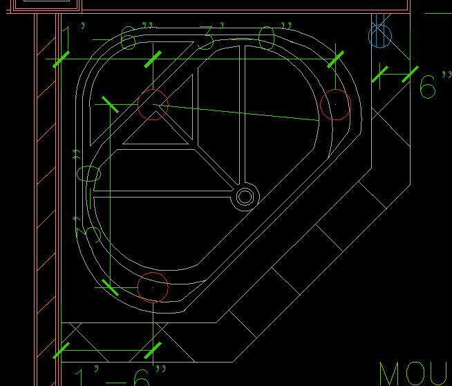

I am using ABS2006. After starting the line command, I select the center point of a circle (which is overlapping an xref). My Ortho is on and my OSnaps are on. I then type @3'

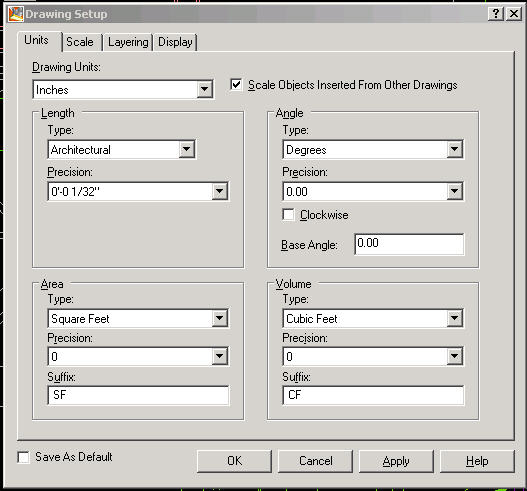

type UNITS, click the direction button. make sure your base angle is 0 degrees East
Im assuming this worked for you. I tried drawing a line with the setting at 90 and it did what you described happened to you. Setting at 0 East will fix it....just in case anyone else ever has this problem and finds this thread.
No, unfortunately. The units are set to a zero base angle. It's weird how the endpoint of the line wants to snap to a point on the xref when the cursor is near the xref itself. Iwould think that the 0 (zero) would overwrite the snap function. see attachments.
It may be an issue with the install. Now some of the OSnaps are not working. Thanks for all of the help.
