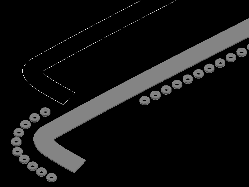

I can add corners but i cant seem to edit the old ones. I use the spline and sweep method but i dont think my friend did it that way and to which extent i cant edit it. Its not a mesh i can tell you that, i think it was probably drawn in 2d and extruded. I cant be to sure. If you can help in some way to edit this kind of 3d model id appreciate it.

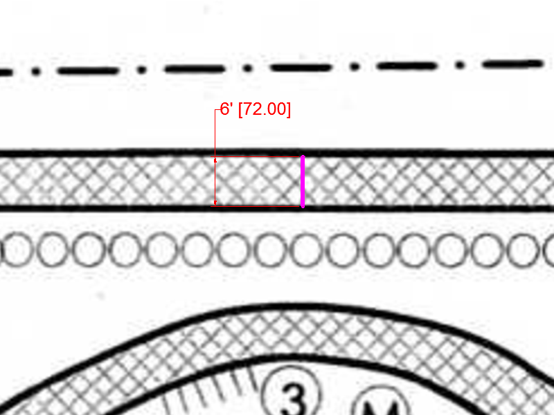

I have a picture of a track layout and i wish to import it to autocad 2011 and have it flat so i can draw a spline around it. But being me i need this to be to perfect scale. The track is 7.5m wide. Is there anyway i can import the image and scale the image of the track so the track is 7.5m on my screen? so when i place a spline around the center and make a 7.5m line and sweep it along the spline it will be to scale.

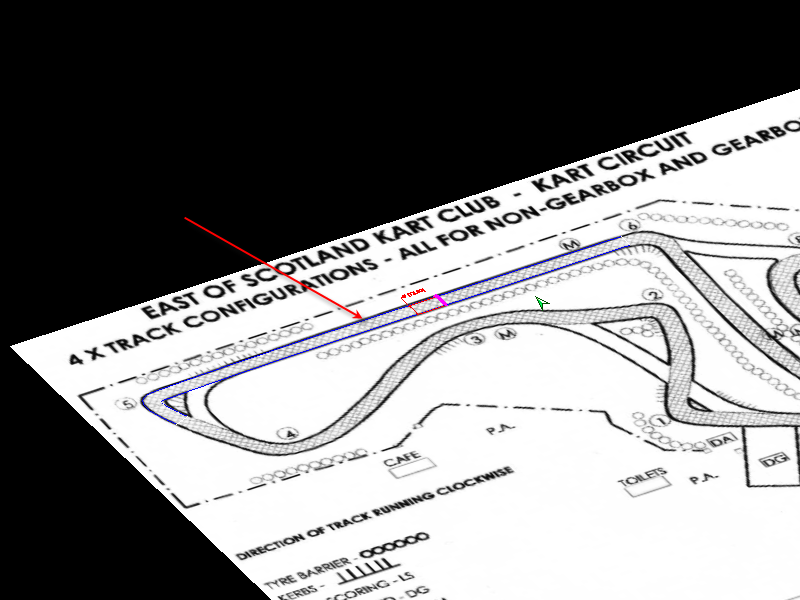

Import your image into AutoCad... Draw a vertical line 7.5mm tall, ( I used 6' for my ref line). select the image and manually scale until you have your track width...
Then you can start tracing out your track with line, splines, or polylines.
Then you can use 'press-pull' to extrude the track. If 'press-pull' can't find a boundary then use the "Hatch" command and it will point out the line breaks for you.
Add you tires and other objects and later using the image for reference only.
