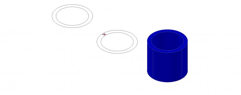

ReMark Posted January 6, 2011 Posted January 6, 2011 Quick example. Start with two circles representing the I.D. and O.D. of your tube. Using the PressPull command click between the two circles (where you see the red "x") then move your mouse in the direction you want to go (up or down). Exact distances can be entered at the keyboard. This is just one of three or four methods that can be used. Quote

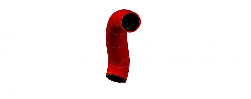

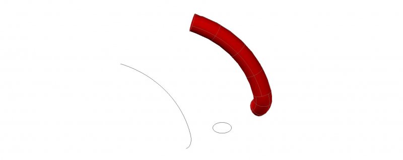

ReMark Posted January 6, 2011 Posted January 6, 2011 An example using the Sweep command. The centerline of the tube is created and then a circle is "swept" along it. A second, close-up, view. Some additional work was done to hollow the tube out. Quote

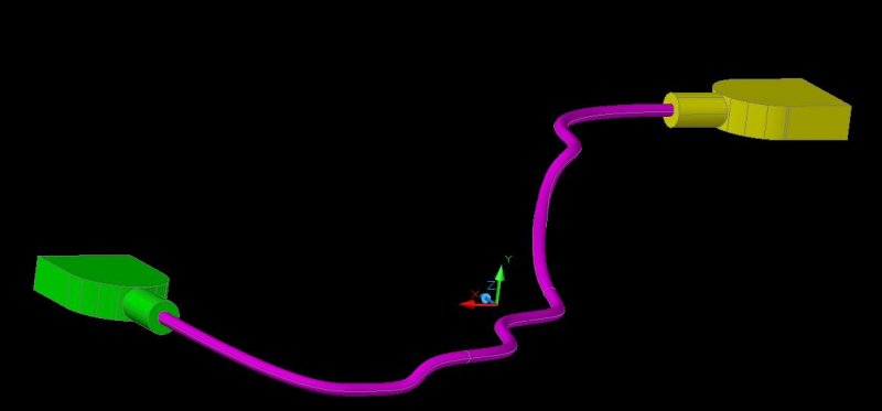

NAILER20 Posted January 6, 2011 Posted January 6, 2011 Hi remark the concept of the tube is bares a striking resemblence to a problem I am haveing with cables I want to for a splined line that connects two misaligned terminals I tried to sweep my spline autocad 2011 mechnical just says n way i've drawn 3d polylines to my connection points then ran a sweep got a non smooth entity and one end is never pointing in the right direction thais is driving me nuts cause I've been doing more and more 3d work and this cable problem is my achilies heal Quote

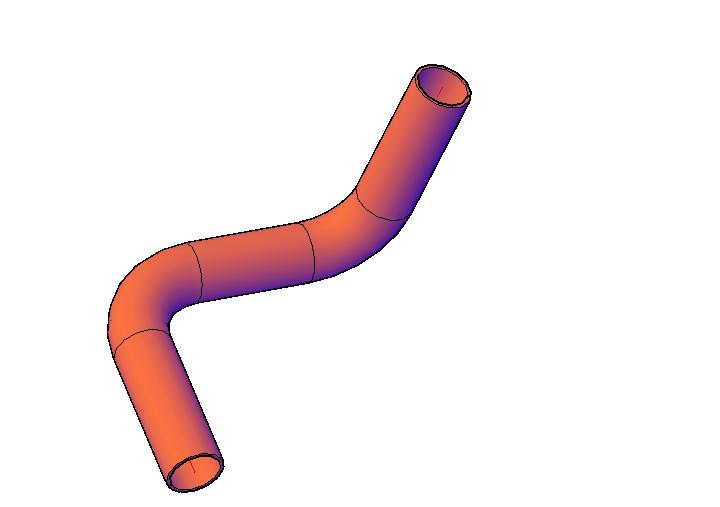

Jack_O'neill Posted January 6, 2011 Posted January 6, 2011 Had some time this afternoon, and this discussion brought back some pleasant memories. Found myself playing around with bending tubes. Here's another using that same method (sorry, this is a bar, didn't put out the effort to make it hollow. By mimicking the action of the bending machine on screen, you can create shapes that can be manufactured with common equipment in tubing shops. This particular example would be difficult on a standard Chiyoda or Pine bender, but with some special dies it could be done. If this were a real part, the machine operator would not have nice things to say about me. Quote
Jack_O'neill Posted January 7, 2011 Posted January 7, 2011 Hi remark the concept of the tube is bares a striking resemblence to a problem I am haveing with cables I want to for a splined line that connects two misaligned terminals I tried to sweep my spline autocad 2011 mechnical just says n way i've drawn 3d polylines to my connection points then ran a sweep got a non smooth entity and one end is never pointing in the right direction thais is driving me nuts cause I've been doing more and more 3d work and this cable problem is my achilies heal Try increasing the value of the FACETRES variable, that might smooth out the dispay for you some. It defaults to 0.5, has a maximum of 10. You mentioned that one end wasn't oriented correctly. Does that end look funny too, like a sort of wedge shape maybe? I found this to be the case when drawing wires that came out of plugs if I didn't have that last segment of the 3dpolyline exactly parallel to the body of the plug. In the pic below the yellow plug is rotated 90° and 1.25 inches above the green plug. The wire between them was created by simply clicking here and there to create the appearance of a random piece of wire that no one had tidied up. Quote
