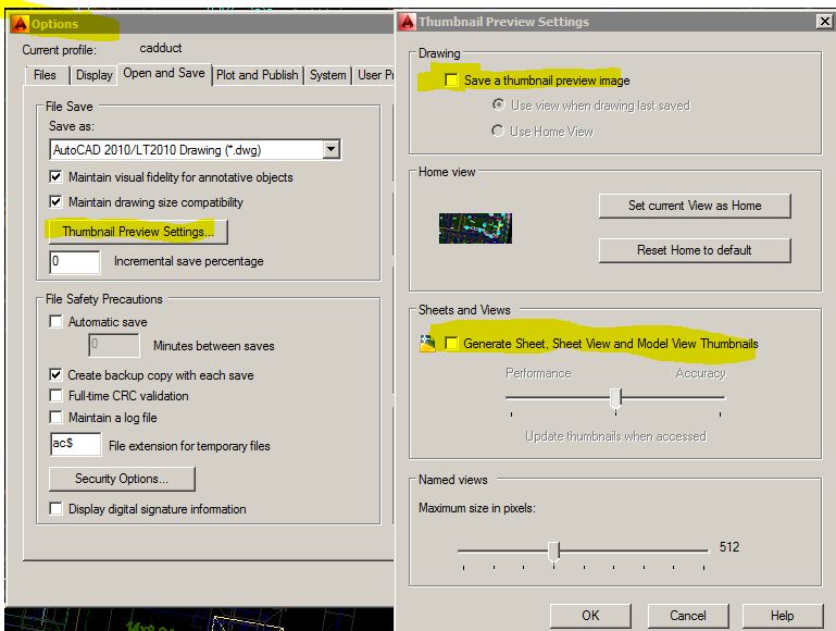

cadbob Posted May 16, 2014 Posted May 16, 2014 I had same problem after installing SSD Drive, but I'm getting error on Network and Local Hard Drive. Not really sure why new hard drive would cause the issue but I have attached the fix that worked for me. If it helps please let me know. Quote
