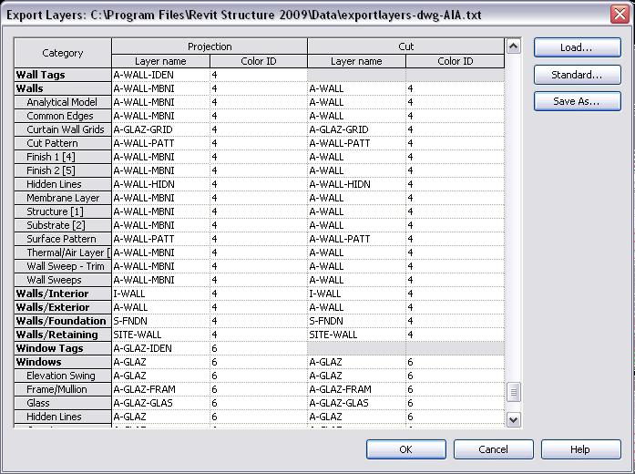

Domdeezy Posted September 26, 2008 Share Posted September 26, 2008 These colors can be changed by clicking File, Import/ Export Settings, Export Layers DWG/DXF. Scroll down the element you wish to change. Then under Color ID column change the pen number to the desired color. These pen numbers are based on the 255 plot style numbers AutoCAD uses. You can also change the layer name is exports to as well under layer name column. Hope this helps. -Dom Quote Link to comment Share on other sites More sharing options...
Hmm.. Posted September 26, 2008 Author Share Posted September 26, 2008 Thank you again! I clicked all the way under the file - export - cad formats - options and also there under layer settings.. every time i open it in CAD the wall is yellow all the way.. Did you try? An the layer is named 3d-WALL.. Quote Link to comment Share on other sites More sharing options...
Domdeezy Posted September 26, 2008 Share Posted September 26, 2008 Yup works both ways work. What you have to do is make sure you change all the wall types. See attached. Quote Link to comment Share on other sites More sharing options...

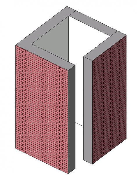

Hmm.. Posted September 29, 2008 Author Share Posted September 29, 2008 Thank you.. you didn't understand me.. I added a pic. Internal surface of this wall differs from outside surface. So I wish to see the same situation when I open it in autocad. Any ideas? Exporting form archicad like a 3DS file, i can import it in autocad, and every surface gets its automatic layer name automatically. Quote Link to comment Share on other sites More sharing options...
Domdeezy Posted September 30, 2008 Share Posted September 30, 2008 Well the best way would be to go File, Export, 3ds Max (FBX). This keeps any materials applied in Revit and surfaces and transfer them to 3ds max. I believe this only works with 2009 products, but am sure you could find a FBX plugin on Autodesk site. Then open 3ds max File, Import, FBX file. Hope this helps. -Dom Quote Link to comment Share on other sites More sharing options...
Hmm.. Posted October 1, 2008 Author Share Posted October 1, 2008 It worked perfectly! somewhere between exports wall length values have changed from, for example 2000 to 1999.9999. But actually its the same.. I'm very happy about that!!! Thank you very + very much!!!:) P.S. Are you well known with 3DS MAX?! Is it good software for designing rooms etc.? Quote Link to comment Share on other sites More sharing options...
