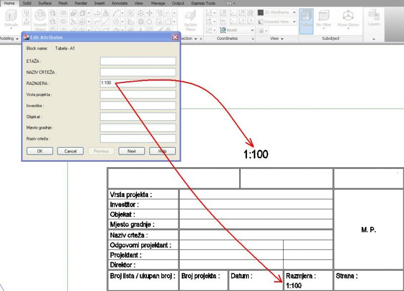

I don't know how to solve this problem. When I enter 1:100 value or something other in Edit Attributes field, I want to change two values on the table. Is it possible? How can I solve that? If it is possible, can you send me any example or explain it in detail. Thanks.
they only way I have been able to do it in the past was write a LISP routine that modified the second attribute based on the first. I'll see if I can find it and separate it from its parent lisp routine. It'll have to wait until Monday as I'm heading out the door.
Ok, basically what I did was grab turn one attribute into a piece of text that contains a field, that field is a custom drawing property. The lisp routine runs based on a reactor whenever a block is edited, if the right block is edited, the attribute is stored in the custom drawing property, allowing the field to update and for both to contain the same text. The following is a hodge podge code that was cobbled together from various programs, it may work as written (other than no variables have been localized) but then again it may not, but it should at least get you a start if you have any experience with LISP programming.
