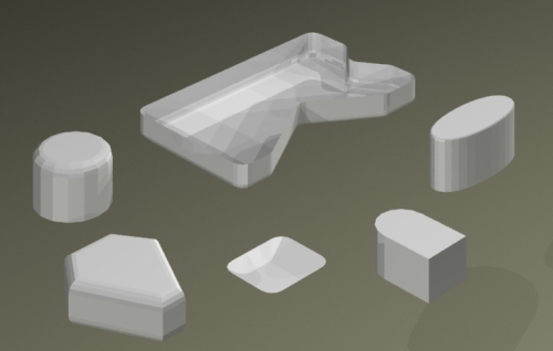

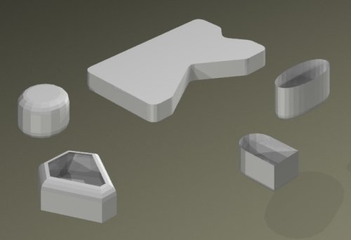

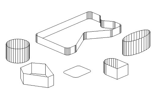

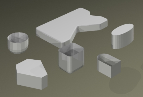

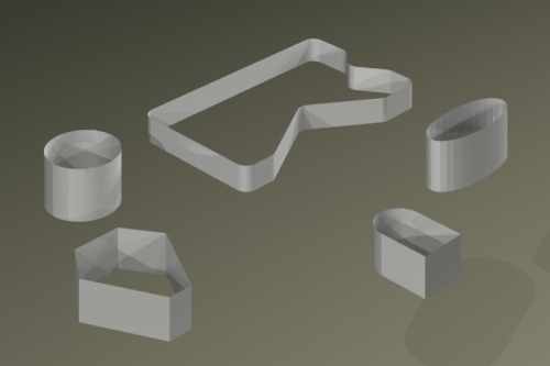

Thought I'd share a new project for the new year : no 3D solids - meshes only
Make a mesh from a closed polyline pattern with optional fillted top and bottom surfaces in a 1 step process via Autolisp.

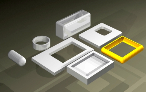

CalCad, I was a bit surprised as well.
Solids seem to have taken over as far as 1 off creations. I doubt you will ever be automate making them ( in Autocad ) other than using a series of ( command ) calls. And that is very problematic.
Meshes still have their places and I like the fact that can be parametrically created. I have written the code for conversion. I have a couple other complex mesh shape generators on hand.

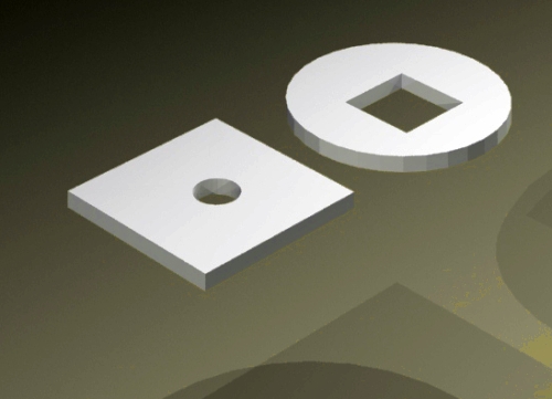

Here is the routine that made filleted corner rectangle in post #3. It also can make a square or filleted hole in a round shape or a round hole in a square or filleted shape.
They come in handy for me at least.
